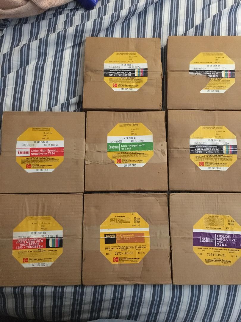

Items are being sold for a friend.
I have purchased expired film from him previously, and sold his supply on APUG previously.
Package does not specify if it's single or double perforated, and does not specify chemical process required
The price is $40.00 per roll, and the USPS shipping charge from 10530 to your location.
Eastman Ektachrome - Video News Film - 7240 - Tungsten: Quantity = 3 400' Rolls
Eastman Color - Negative II Film - 7247: Quantity = 1 400' Roll
Eastman Ektachrome - Video News Film - 7250 - Tungsten: Quantity = 1 400' Roll
****** Sold ******* Eastman Color - Negative Film - 7254: Quantity = 1 400' Roll ******** Sold *******
******* Sold ****** Eastman Color - High Speed Negative Film - 7294: Quantity = 1 400' Roll ******* Sold ******

Single or double perf?
Donald Qualls
Jan 19, 2005
12,073
North Carolina
Chemical process ought to be ECN-2 for color negative (at least if it's less than about 35 years old) and E-6 for the Ektachrome -- but it's probably single. Most modern cameras use single, and single-perf cameras can use double without mechanical issues (but the perfs will get into the image area).
My interest would have been for submini still cameras (Minolta 16 family and Kiev 30 or 303), which don't depend on perfs -- but the larger frame models prefer single perf for the same reason.

2R on the label means double perf.
16 mm End Use Perforations
2R-2994—16 mm film perforated two edges with a perforation pitch of 0.2994 in. (7.605 mm), short pitch,
ANSI / SMPTE 109-2003
2R-3000—16 mm film perforated two edges with a perforation pitch of 0.3000 in. (7.620 mm), long pitch,
1R-2994—Same as 2R-2994 except perforated one edge, ANSI / SMPTE 109-2003
1R-3000—Same as 2R-3000 except perforated one edge, ANSI / SMPTE 109-2003

How do these negative films do in B&W chemistry then printing?
Donald Qualls
Jan 19, 2005
12,073
North Carolina
The ECN-2 color films will be much like C-41 films -- that is, they'll have an orange mask and possibly a dark filter layer (which would be removed by bleach in the color process), so will be annoying to print (as if heavily fogged). And you'd still have to remove the remjet antihalation coating.
