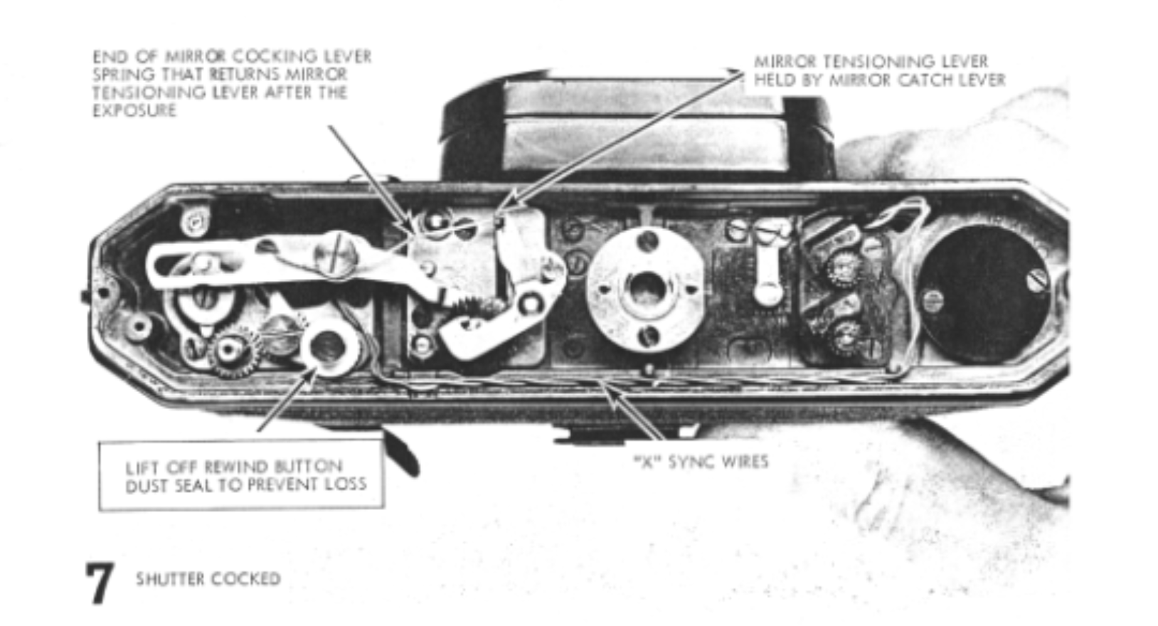

There are a couple of common problems with Spotmatics that have to do with the mirror charge lever, which can result in (I think) either the mirror sticking up or the camera not firing, depending on where you are in the the cycle when the mirror charge lever is disengaged from the thingy it's supposed to be engaged to. You can look at this thread for some discussion: https://www.photrio.com/forum/threads/pentax-spotmatic-sp-stuck-mirror.210187/
The pictured mechanism is under the bottom plate so it is not hard to access, although finding a lasting solution may be harder.

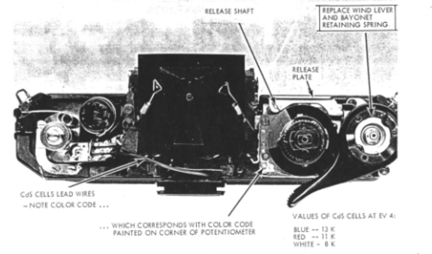

Start by removing the top and bottom cover. See if you can determine the cause. You do need to know the shutter activation sequence and the location of the gears and levers for such.
Sounds like a Jobe fore this weekend. I must admit...last might those screw were beckoning me. Especially, after 1 or 2 Spotted Cows.
I may give it a look this weekend. Thanks for the link. The mirror looks to be in the correct position -- and I can look through the viewfinder. I will check out that lever. As many have said. Probably needs a CLA.
I've taken the bottom off a Spotmatic without ruining it. There's a lot going on down there. I looked for gunk, may have deposited a couple micrograms of a solvent/ lubricant. Not sure if I did anything.

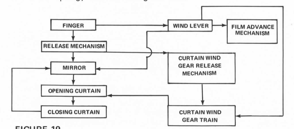

The Spotmatic uses a clutch in the winding and cocking mechanism which allows the shutter to unwind on its own This clutch is somewhat delicate and will jam the advance when it fails. This could explain your problem? There is a nice repair manual by NatCam if you want to take a closer look. But its more than likely that the camera also needs attention elsewhere.
