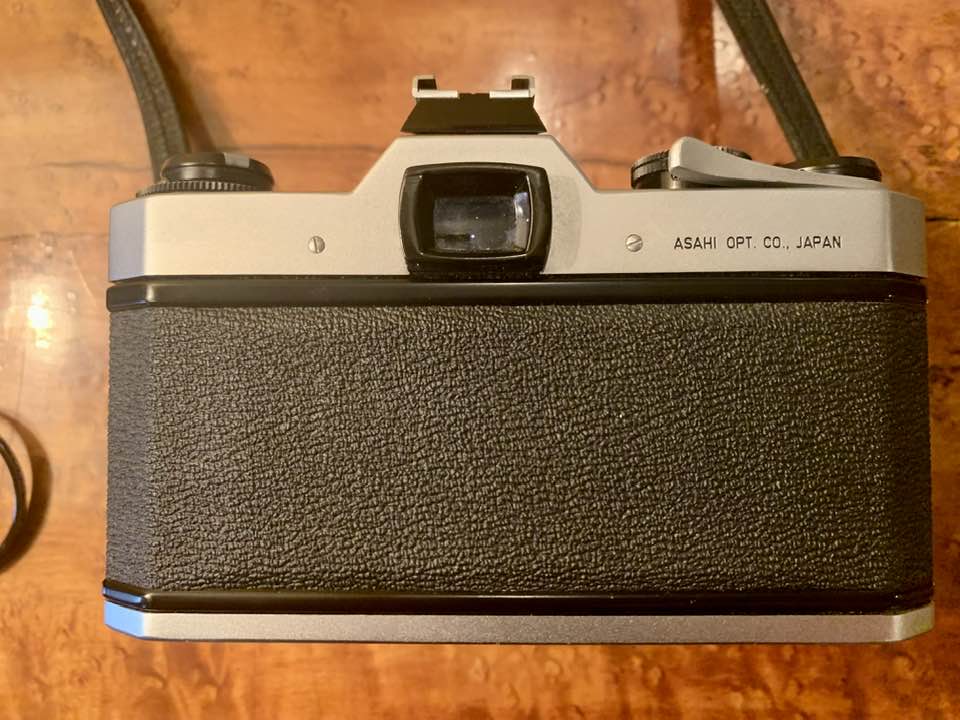

I am selling an excellent condition Spotmatic II with a sweet 50mm f1.4 M42 screw back lens.
Includes an original Pentax leather half case with leather strap, original Pentax UV filter and an original metal Pentax lens cap.
And the original owners manual and catalogs.
NOT FOR SALE - WITHDRAWN
A great Christmas present!
