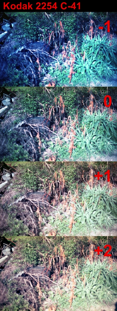

Anyone still shooting this stock out of their freezer? I've only shot in daylight, but exposure has big impact on the color temperature. Here are a few frames:
Bracketed negatives
Tweaked in post
