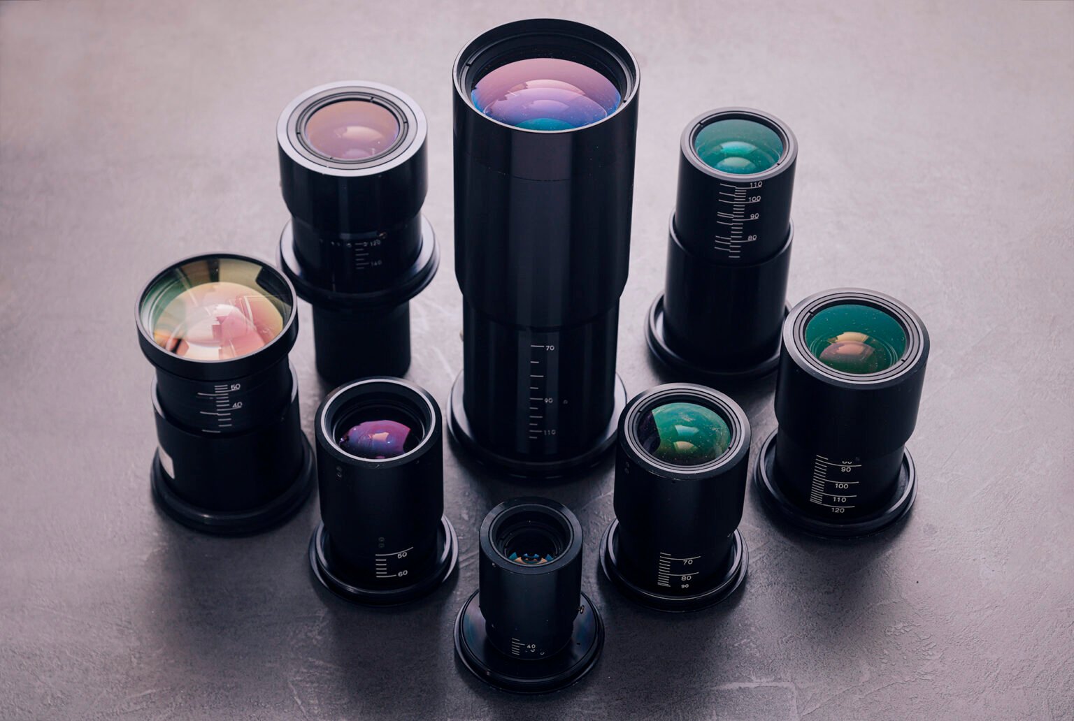

I've finally been able to publish a first version of a pretty extensive article on lenses labeled Noritsu, mainly used in their minilabs. I use a couple of those regularly adapted onto my bellows system and have grown quite fond of some of them. Unfortunately it's quite challenging finding information (it was great reading about the experiences of some people here in the thread about former minilab operators on this forum, but even most of those seem to lack any detailed knowledge on the lenses themselves...), so I'm well aware that the article still features a lot of speculation. If you happen to know anything about who the possible manufacturers (I currently know that both Tamron, as well as Nikon provided at least one lens for Noritsu minilabs) could have been, or find anything else in there which might need some corrections/additional information, I'd really appreciate it if you could let me know.
If you're interested in such a (niche) topic, you can find the article here:
https://deltalenses.com/the-makers-noritsu/

@simplejoy congrats on the publication; it's admirable how much effort you put into researching the topic, the article is very nice to read and the example photos are useful as well as a joy to watch!

Thank you very much - I'm glad you like it!
