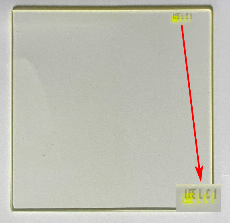

I do not like to be made a fool. (I can do that myself.)
You refer to a "Lee Low Contrast 1" filter and describe it as having "a light yellow, washed out tint" .
I do not remember such filter, but nonetheless spent 20minutes at Lee catalogs searching for such. In vain.
Thus I consider my question substantiated.
The best I can think of is a series of Lee mist filters (p.73), that Lee describe as "white", your description though indicates to me that it is a colour filter and made me wonder how it could work.

I post on this topic again because the content of the document re: profiling the Imago PP has changed significantly.
Soon after I posted the link to the first version of the paper I had an interesting meeting with Susanna Kraus in her atelier here in Berlin and I learnt that the Imago devours developers and that the blacks I was getting -- pleasant but rather "relaxed" -- could be replaced by truly stunning ones. She told me that the key was developing at high temperatures. (In spite of the manufacturer's instructions to work at 20C/68F.)
I have made a few more tests and added a third chapter to the document. In this new chapter I report the results when developing with the Jobo CPP-2 (and not in trays as in Chapter 2), at 27C-32C (81F-90F) and using a strong Tiffen Low Contrast Filter 3 (instead of the weaker Lee Low Contrast 1 as in Chapter 2) that I recently purchased.
The new paper has the same link as before: https://www.marcoannaratone.photography/Tests-(PDFs)/thumbs
Those of you who downloaded the paper before should download it again (and throw away the old one) because the latest one is quite different and more complete.
The condensed version of the paper is that Susanna was 101% correct
