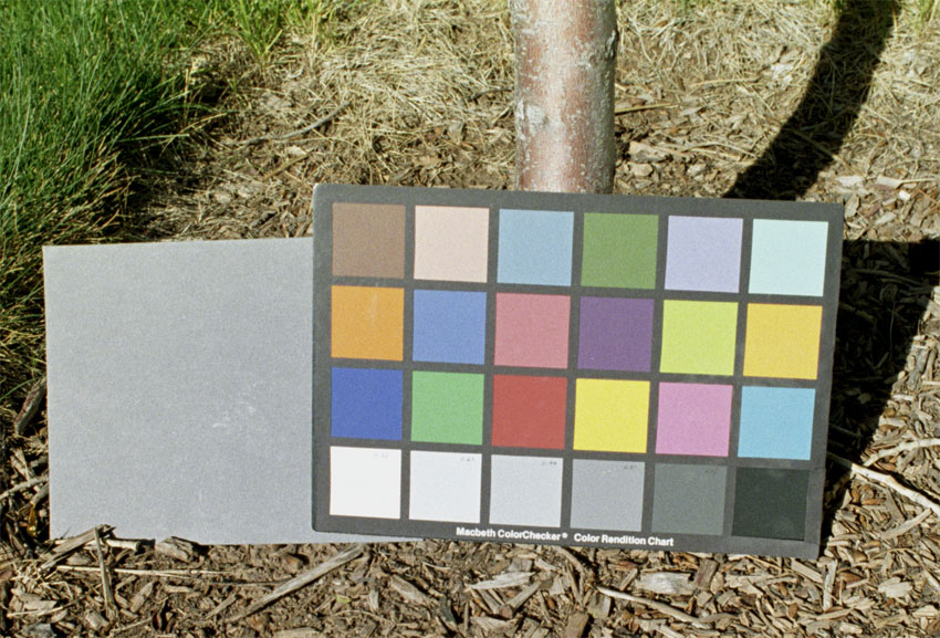

Here are two samples of negative scans from Arista 100 that was exposed at ASA 50 and processed 3.5 min in my scratch-mix C41. Processing time in the developer was 3.5 min at pH 10.2. The negative Dmax is a little light and the saturation is low. Both exposures were made with Minolta 7000 auto settings using a Minolta 28 mm lens. The MacBeth chart picture is about 1/3 of the entire negative, and the St. Michael Mtns. picture is a full frame scan. Both images are flat sunlight illumination.
The negative scans were made using Nikon 9000 ED auto settings. The scan brightness was adjusted down about 10% with PS to yield these images. Arista film might be acceptable to some who plan only to scan, but certainly it's not likely to be acceptable for printing. With such low saturation it will be very difficult to make acceptable prints, in my opinion. On the other hand, because the film is advertised as inexpensive for students, it might be just the thing to use for learning. If you are able to make good prints from these negatives then you probably have pretty much mastered color printing.
Saturation might be improved somewhat by rating the film at ASA 25 and reducing development time to say 3 minutes, but the contrast isn't very good as it is at ASA 50, and will suffer further by shortening development time or increasing the developer pH. I am just guessing when I conclude the film simply doesn't have enough silver content to yield good color saturation. The color balance doesn't appear too bad, but one cannot really compare with the really excellent films that are in today's market.

It doesn't look as bad as all that, and the price is right. It looks overexposed and scanned to me. I might just have to try me some.

Looks like an interesting film. Those scans look fine to me, especially if you are going for that effect. I'd like to find a film that would be close to the old 5035 Kodacolor II for those times when I don't want such a modern look.
