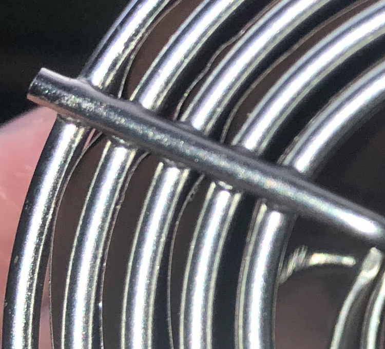

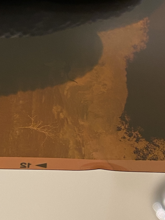

The lid seal around the first lid I got was bad and leaked all over, so I was sent a replacement. One consistent issue I've had is these deep dents on my film where the film sits on the crossbars that run along the outside of the reels. Not sure if it's something I'm doing wrong or if there's an issue with the reel. Wanted to post photos and ask if anyone has any advice.

I am new to processing color and it's been a while since I had processed any film at all, but I've never had an issue like this before. Not sure what I'm doing wrong. Here's a photo of the reels loaded - you can see the film bending at the crossbars on both sides, as in photo #3 above - so it isn't that I'm loading it unevenly and one side has room and the other side is crammed up against the crossbar. So I'm pretty stumped.

Yes, it is catching at the cross bars and the film should not be doing that. Call FreeStyle and explain the problem. I like to talk to Oliver Tam there.

I would bet that the reels are bent. Are the top and bottom parallel?

I just laid it on my palm and did a little spin test - you're right, they're warped and wonky!
