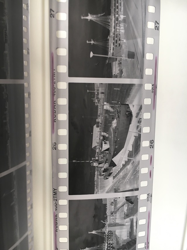

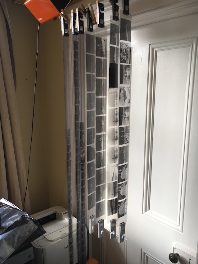

Last night I loaded 7 films onto Hewes stainless steel reels (3x 35mm and 4x 120) without problems. I should have given up on Paterson reels a long time ago. The Hewes reels I have fit the centre column of Paterson tanks so I can still use my Paterson gear. The only thing I noticed was that the purple dye of TMax 400 persisted in some patches on the very edge of the 35mm films (but not the 120). All of the film was TMax 400 in freshly made up rapid fixer and processed in 2 batches of Tank 1: 1x 120 +3x 35mm and Tank 2: 3x 120. Only the 35mm showed purple on the edges. I'm assuming this is from film touching the reel and I'm not going to worry about it.
