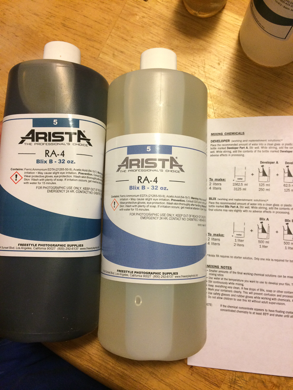

Arista RA-4 kit; got two blix B's. Can someone tell me which is actually B?

I'm shooting a note off to Freestyle but in the meantime I'm wondering if I could get someone who's had these kits to help.
I opened up my RA-4 kit and the blix chems, though obviously part A and part B are both labeled part B.
If you've used these kits or know for a fact, then can you tell me which is actually the B?

OH...so these are just separate bleach and fixer? I can actually use them separately if I wanted to?
No, you can not use them separately, because a bleach consists of oxidizer and counter anion for Silver. In a BLIX, the fixer part plays the role of the counter anion.

To answer the original question rpavich asked: Freestyle conveniently provides MSDS for most photochemistry related products they carry, and the MSDS for this Arista kit makes it obvious which BLIX part is which:
  • BLIX PART A lists Ammonium Thiosulfate and Sodium Metabisulfite
  • BLIX PART B lists Acetic Acid and Ferric Ammonium EDTA
Since Ammonium Ferric EDTA has a very distinct color (deep red), it is therefore clear that Arista's BLIX PART A is the bottle with the light yellow liquid, whereas Arista's BLIX PART B is the bottle with the deep red liquid.

Thanks everyone, this was quite informative and Freestyle got back to me also and confirmed what Rudeofus said above, that the B is the darker liquid.
If my paper comes today as it should, I'm going to try and do a test print...very excited.
