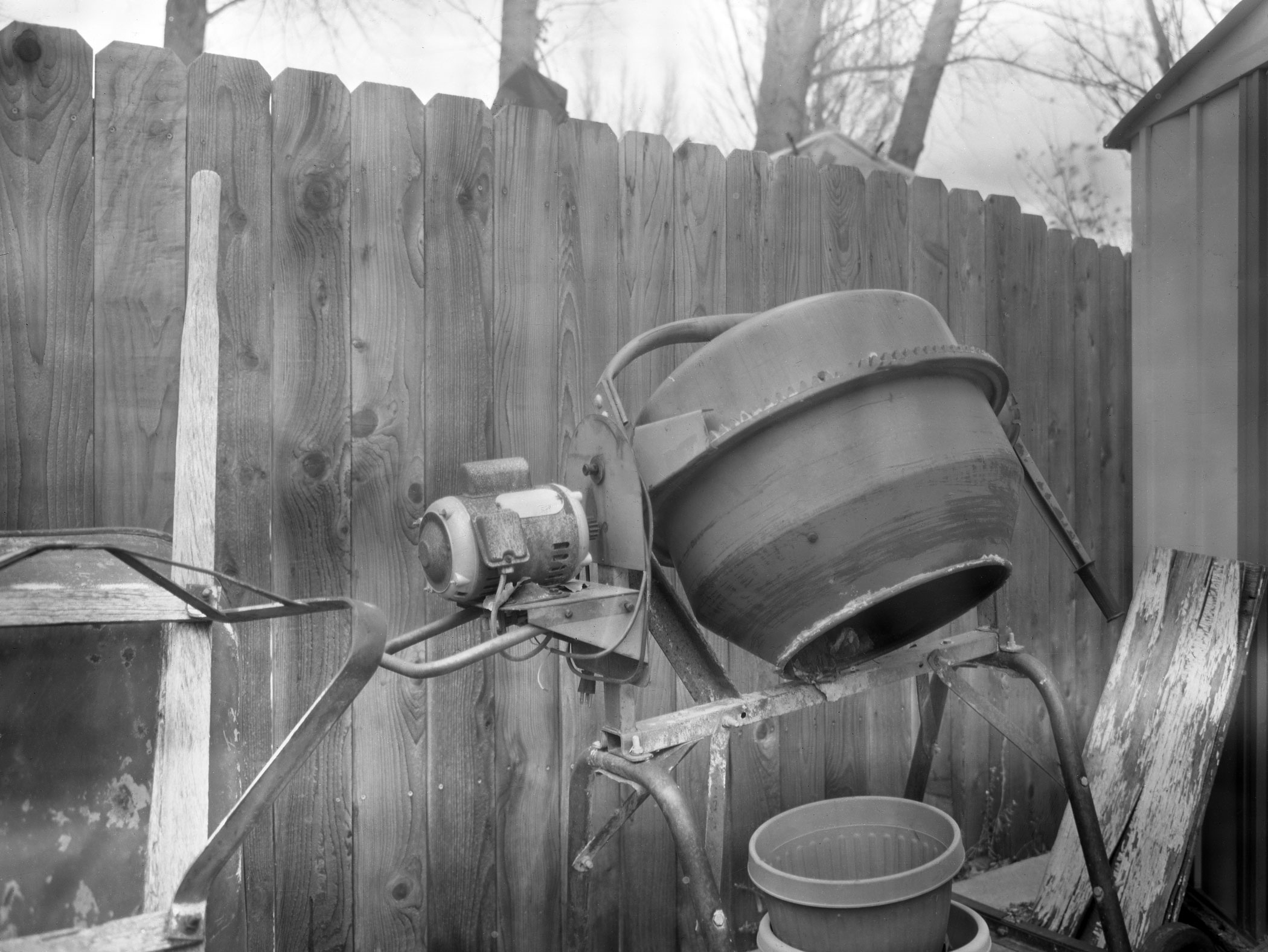

For those who may have some coffee and Kodalith lying about.
This is some pretty old Kodak Ortho Litho film exposed at EI-1.5 and then developed in a soup of Caffenol consisting of 4 cups water brewed with 4 tablespoons of ground Sumatra beans then mixed with 5 tablespoons of Sodium Carbonate. I brought the mix to a full liter using ice cubes and water to help drop the temp to 69F. I then agitated continuously in a tray of 500ml of the above described solution for 5 miutes and 15 seconds.
Cement Tools -
This is the best of the 4 sheets I exposed. Perhaps due to the age of the film it seems very sensitive to staining but it does work in Caffenol. I am also experiencing some light leaks on the edges, probably caused by pulling the darkslide all the way out on the old film holders I am using. Although the Arista Ortho Litho is much easier to with I will not be turning down any old Kodak Litho film that people may want to get rid of since it is certainly usable with this solution.
