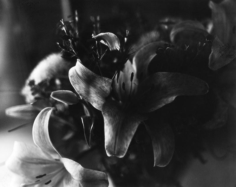

Yesterday I made some test exposures with the Arista Ortho Litho 2.0 (which I'll call "AOL2.0" for brevity), using a 135-f/5.6 Fujinon lens on a Speed Graphic. I used Tetenal Centrabrom-S low-contrast paper developer diluted 1:15. With a slight amount of preflashing, I found ISO 6 was good for shaded daylight and ISO 12 for cloudy skies. I have yet to test this film under harsh, direct sunlight, but expect it to be very contrasty without using some dilute film developer, which will be my next round of tests.
Here are several images from yesterday's tests.

Nce try, but the images are still far too contrasty for my taste, particularly the flowers.

The portrait looks really good to my eyes. What do you plan to do with these negatives, Joe? Contact print?
These images are enlargements to 8x10 onto Ilford MG RC WT paper. At this scale, the detail holds up very nicely.
And I agree with the other poster that the contrast is not yet ideal, but they aren't too bad considering I was using paper developer. I'm thinking about using this same low-contrast Tetenal developer with Harman DPP (yes, I still have some left).
