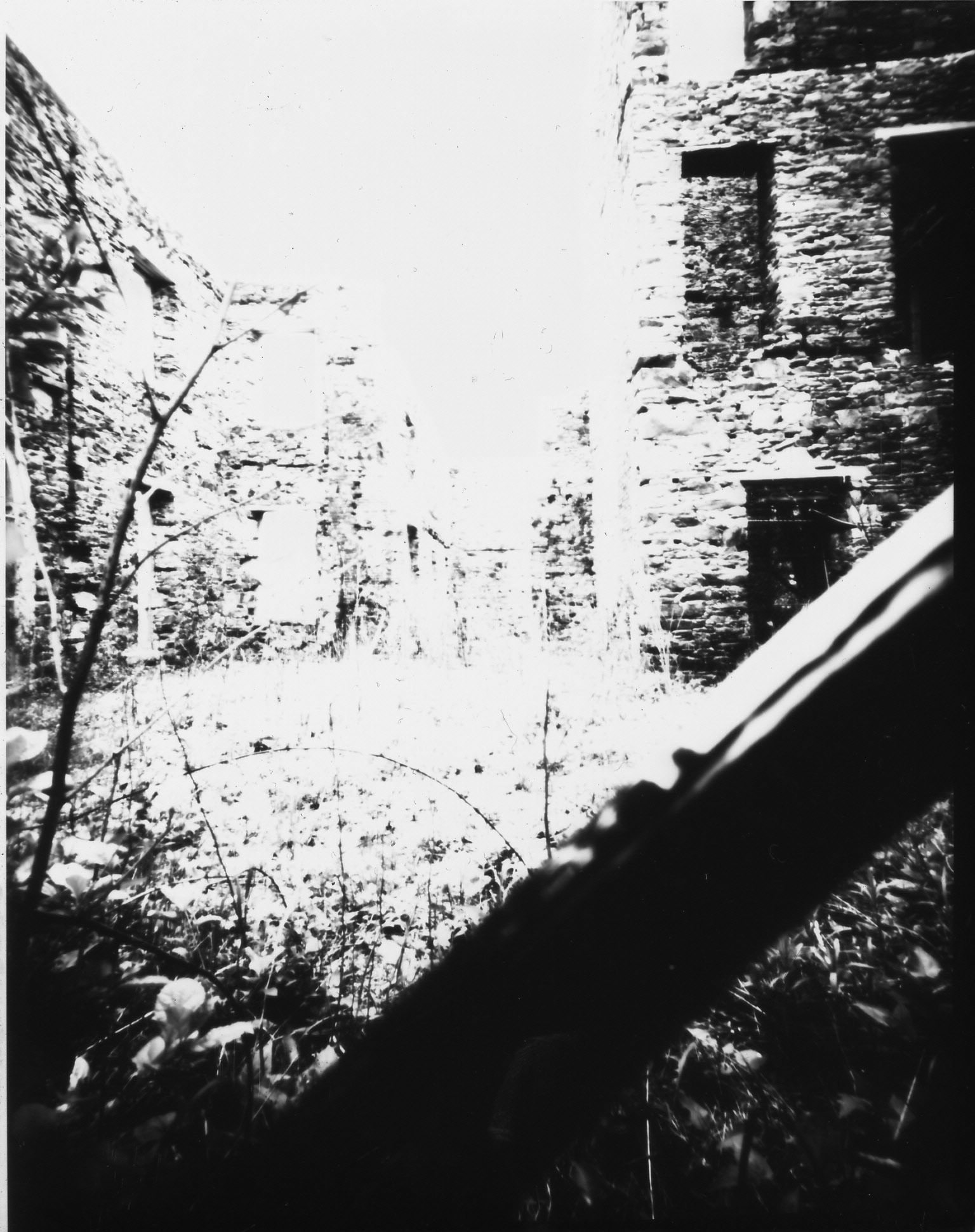

This past weekend I shot some Arista Ortho Litho 2.0 4x5 film. I developed it in a tray with LPD developer 1:4. I'm wondering is this the wrong paper developer for continuous tone or did I not dilute it enough? Oh and for what it's worth I shot it in a Harman Titan pinhole camera.
Attached is an inverted scan of the photo.
TIA.

Apparently not. Perhaps you'd be better off with a phenidone-type developer. As for me I use Willi Beutler's on X-ray film and manage to climb at least partway out of the contrast pit. Don't bother with Dektol either, or even high-dilution D-76. Looks like you need some serious contrast-buster to me.

I don't understand the rationale of using (inherently high contrast) paper developers with these films; it strikes me that it makes sense to start with very low contrast developers ...
I thought D23 would be a better bet, and that seems to be confirmed by another forum member who says he has been getting good results from this film using D23 diluted up to 1:14 while shooting at EI around 1 or even 1/2
(see this thread: (there was a url link here which no longer exists))
Ive had problems with that film as continuous tone as well. I tried very diluted LPD, Dektol, and D76, but still got really harsh images. I may try Rodinal stand 1:100, as that worked in the past for me with some old kodalith films to create continuous tone images that were less contrasty.

You need to check out Beutlers. It stretches contrast-control to the bitter end as available out of a simple Metol-Sulfite mix.
Thanks. I have read some on Beutler's Developer when I was doing research on Barry Thornton's Two Bath developer. I use BTTB for most of my work (except IR and a few other films). Do you think it would work as well as Beutler's?

I'm not familiar with the Thorntons. I've never fooled with 2-bath developers. To me all they are is a second bath of a stronger alkali to force the remaining developer that has soaked into the emulsion, to exhaust itself more completely in the areas of low density. I don't see much useful benefit. It might raise these areas up from the toe of the curve to some small degree, but nothing truly miraculous. But now it's only my opinion.Somebody else might say I'm full of it.
Edit: on X-ray film, D-23 has not done the trick for me. Still too contrasty.
I might mention that I've been using a good bit more dilute Beutlers than is called for in the Beutlers instructions. I experimented and found 1,1,16 to make X-ray film look pretty good. You have to pin down a film speed and keep meters and shutters in calibration. There's no latitude there. You can block up densitiy all too easily, and still not get the low density off the toe.

This was Perceptol 1+1 for 3 minutes, scanned and inverted only -- not because I thought Perceptol was a particularly good match for Ortho Litho film. Rather, I was killing two birds with one stone -- doing a close focus test and "proofing" newly mixed developer.
If I wasn't such a dirt-poor cheapskate, you know what I'd do if I had to perform a whole new series of experiments on this high-contrast ortho stuff? I' send off for a few cans of Acu-1 developer and play with that a while. Remember, all you're trying to do is snatch 10 reasonably linear zones out from between a baseline and top line that are already very close together. It can be done, because I've done it with Beutlers. Probably would have been easier if I had broken down and bought some Acu-1. Just an afterthought.

I use mine at iso 1, 2 or 3 and develop normally in hc:b. 5 minutes, shake every 30 seconds.
POTA, 12 min. works fine with Efke Orthocromatic 25, 35mm.
I can tell you one thing: over-exposed Arista Ortho in Rodinol 1/150 for 20 minutes in a roller gives you BLACK and WHITE. None of that gray stuff in the middle. Mistakes tell you some things after all :wink:

Paper developers are by their nature more active than are film developers, thus they produce more contrasty results.
Use your film developer and dilute it 1+4 or 1+5 and your results will be less contrasty. If you use HC 110 try a dilution of about 1+100 to 1+150. My personal choice is a very dilute alteration of D-23.
