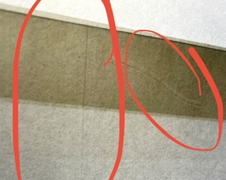

Just to show what I mean.
She wavy scratch is made by me and then there is a very fine thin and super straight scratch, that is more or less in every single sheet and causing a thin line on enlarging

Faith. Good luck with that approach. But you aren't actually saving money that way if you're having so many problems. I've never had scratches with Arista Litho myself, but don't use it all that often, and mainly only as a high contrast lith film in relation to highlight masks, not soft contrast masks. But not too long ago I did use some for a succesful moderate contrast application. I don't know if any significant changes to it have transpired or not. What country of manufacture is printed on the box? Linear scratch patterns do sound like a cutting line issue. So I hope you get some kind of answer from Freestyle.
As far as what others might have said or briefly experimented with, Ctein personally stockpiled and used Kodak Pan Masking film, and almost entirely in relation to dye transfer printing. That film was equivalent to Plus X Pan sheet film minus the anti-halation layer. Nobody back then did contrast masks with Kodalith, or even Tech Pan, because there were so much more cooperative films. But if you are budget-constrained to use an ortho litho film, I wouldn't give up on Arista quite yet. Maybe they can send you a replacement box to test.

Hi Drew,
I have another box of 5x7 and 2 boxes of 4x5. I will see if they have any of these straight lines. At least at the beginning, while I am still earning the craft, ortho lith film is cheap enough so I can do mistakes without breaking the bank. I mean I compare this a cheap seat film, like Foma 100, (50x 4x5 is £42.50) compare to Arista 100x 4x5 at $19, even with shipping and customs this thing is still too cheap. Right now, I can get max density 0.35 which is very reasonable for unsharp mask and good tonal separation at 10 sec exposure and 2 min development. I can do a similar thing for CRM, lower density with shorter development and longer exposure, so the shadows are getting more muddy.
As said, at some point I will do the same process with FP4 for C41 negatives where probably I will develop my skills further so I might drop Arista completely.
However, for the time being, those straight lines are probably a manufacturing defect and I hope Freestyle will solve my issue one way or another.
