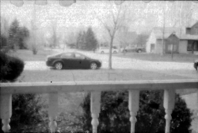

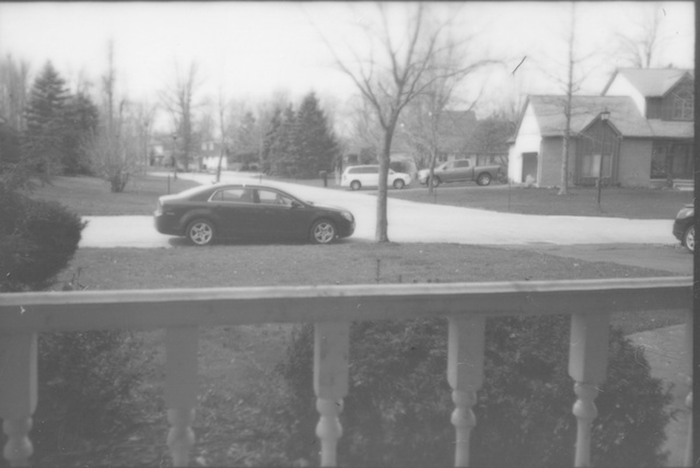

This is my first time posting, and just recently got into rolling, developing my own film. I figured for a start I would try Arista EDU ULTRA ISO 200. So far I have had less than great results. The images are thin and have very little contrast. I have snooping around the forums for answers, but haven't found anything I haven't already tried. Are some of these rolls lemons cause they come from the Czech Republic? Or should I just have spent the extra $20 on TriX?
These are the steps I have checked for error so far:
-Film in bulk loader with correct orientation
-Shot tests through multiple cameras
-Used chemistry to develop TMax 400 and came out fine
-Used stock D-76 for recommended 5-6 mins
-Used stock D-76 and push processed for 10 mins
-Used D-76 1:1 and processed for 10 mins
So yeah, i've been trying to find a sweet spot for this film and all my results end up pretty similar. If anyone has any input i'd greatly appreciate it. If I can't get any better results in the next couple days i'll just order some TriX and be done with it.
BTW, I use all Kodak chemistry, but just started so don't know how much that will effect development. Thanks!!

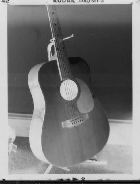

TMAX 400 (120)developed in same chemistry, all standard times.

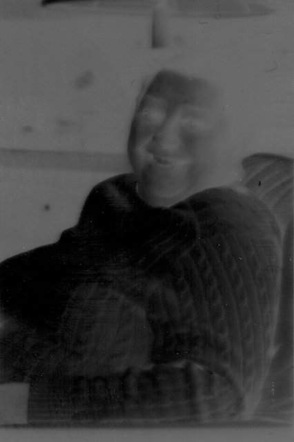

Arista 200 (135)developed all standard times

If your negative is coming out thin and low in contrast, you might want to increase your development time by 20% and see what happens.
I saw your second example, but I see the image is out of foucs and looks like your subject moved as well. Without knowing what color the clothing was, it's kind of hard to judge the contrast - but I do see the hair rendered pretty white and the sweater with good density. I also see that scene may have been back lit with not much light going to the face. It may just be a bad example. Do you have another?

For a true test, I would shoot the two film, same format on the same subject. But it looks like you have 2 shots done one 2 different formats. The shot on the bottom looks like a contrasty scene while it's under exposed and over developed. Correct me if I'm wrong. Also, T-max film has a clearer film base than Arista. I've used Arista Ultra EDU in 35mm and 120. My only complaint is that the film base is too curly. But they've fixed the problem.

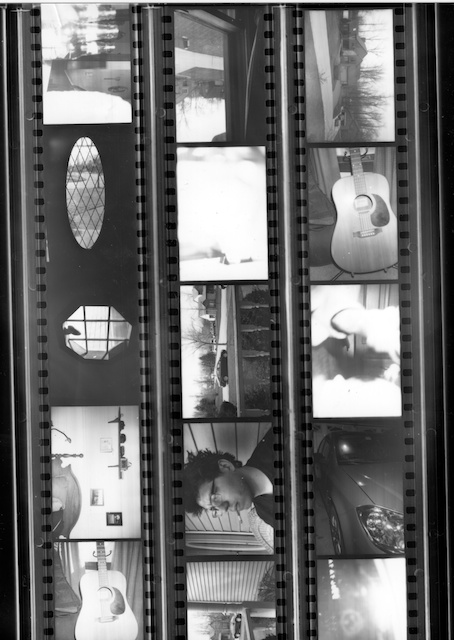

I made a ghetto contact sheet and the results were much more promising then my scans. Yet another reason im happy to try and keep the process all analog. Sorry I have to start with a new set of frames, but I wasn't even sure this old paper would develop.
I just use a 3in1 scan combo for these, cause i'd rather buy film then a v500 or something. Not really looking for info on that, just saying. Would be open to darkroom tips since I'm acquiring gear bit by bit, but i'll probably just troll the forums.
So heres a comparison of the contact vs straight scan. At least this time the same frames. It really looks more like a scanning issue. Nonetheless the testing will continue!!

Although this is entertaining if I can't get better results with a couple tweaks looks like Tri-X is in my future.
