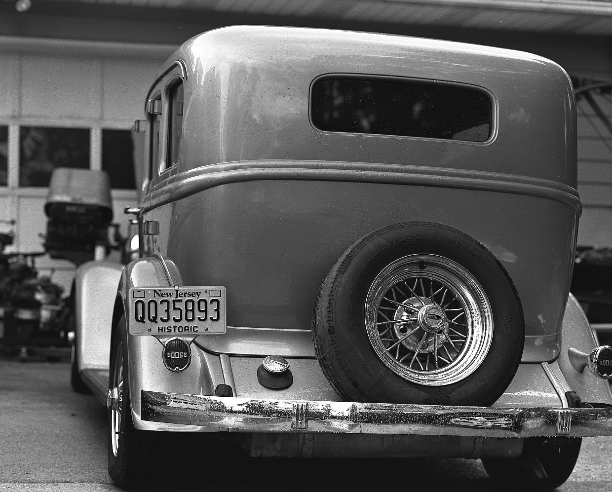

I see the same thing. And, when the roll is done the tape is useless to secure the finished roll. It doesn't stick. I use a rubber band to keep the roll wrapped tight, and then put it in a black plastid can for safe keeping until ready to develop, so it doesn't get light leaks.
It seems like nice film, though. But, I do make an effort to keep it rolled up tight while handling it so I don't get light leaks.

jstout, that is a nice picture, the film looks great. Question, is it softer than something from Kodak or Ilford? Another words, scratch easier? TY
Thanks Fotch, for the nice compliment. I will defer to others here with infinitely more experience handling different films in varying conditions, on the issue of vulnerabity of the emulsion, as I am relatively new at developing. My process is to pre-rinse this film (and rinse between steps), use a Kodak hardening fixer, and I am very careful handling the film, and to date haven't noticed any glaring issues.
Beautiful image. I always was curious about this film and what it can produce. I'm digging the price too. Thanks for posting.
