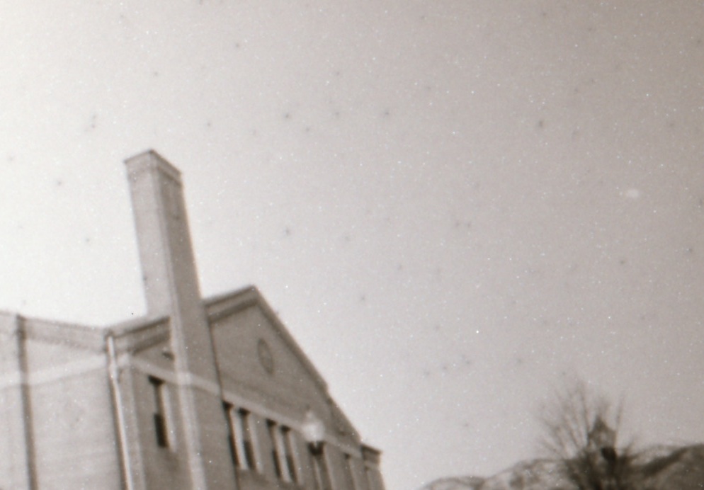

a sample of the problem, if it is one
Here's a cutout sample showing the blotching, or whatever it is -- it almost looks like clumping, hard to say .... this is a small segment of a 4 by 5 neg, perhaps half an inch across.
Another observation -- I notice this problem most on negatives shot with the camera in its 25mm mode -- extreme wide-angle. At 50mm I don't see it -- could it be a factor of the acute angle the light hits the film? At the farther reaches of the film the angle is awfully acute, not to mention pretty dim.
I do pre-soak the film, if only to get rid of the blue/green anti-hillation backing so my chemistry stays clear. I try to watch my temperatures as closely as a kitchen sink and thermometer allows, so I don't think it's reticulation.

I had problems like this with this film. I ended up switching to tf-4 fixer and it took care of the problem. Kodak and foma fixer didn't take care of it, nor did changing developers. I'm really glad, not just so I can continue to use the film, but because tf-4 is a great fixer for all film.
Similar issues can be caused by dust as well, but you'd see non-round things like strands of fiber material and such. If you're new to 4x5, clean your holders before you load them and keep them in dust free conditions except when in the camera. I use anti-static plastic bags for my holders.
