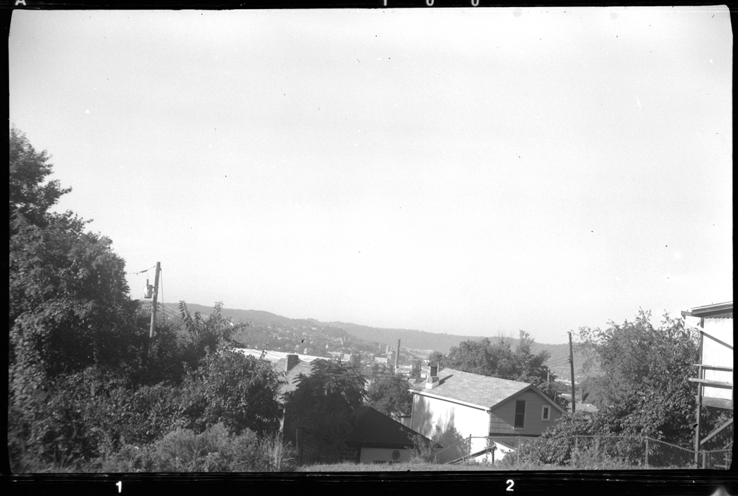

Arista EDU 100 plus used in a Voigtlander Bessa, no number, 6x9 folder with two red ruby Windows, does not quite line up. But it is good enough to use.
When the film was removed, it was bunched a little on the side of the numbers which may have accounted for misalignment of numbers in the window.
But the winding crank was pushed in all the way so it was tight and did not let loose and back wind any. That is warned about in the manual. It had to be learned the hard way.
I still get good pictures.
If I keep using this camera I'll master it eventually. It is my pocket camera.
I began shooting on the first of the 4 white squares, adding one each wind. After #4 had been reached, the remaining shots were done on the last square, never on the number. The hole in the backing paper had me worried.

Two things happened to make the film off center. One was that the pressure tab on the feed spool on the top or number side, left top, was too far in. I pulled it out more with an exact knife, as there is a hole in it to allow for that. That pushed the roll of film further towards the center of the camera. The other is that the wind up film spool needs to have the cross and not the bar. The bar alone will not be enough to engage the winder at all or not all the time. That didn't happen when I shot the film. But it did happen when I practiced with old backing paper on spools and with old developed film on backing paper. That is when I learned about the cross being necessary on the take up spool.
Numbers did eventually line up correctly in the center of the ruby window. And I got it to happen more than one time. Film backing paper did not get crinkled along one edge any more.
Arista numbers are easily seen in dim light. The backing paper is black and the markings are light gray.
This film has been used before in this camera and no hold bothered any image. I used the numbers in the ruby window when winding it. This time I used the number 4 square just to add a little at the tail of the roll to be sure as it was pretty close to the hole.

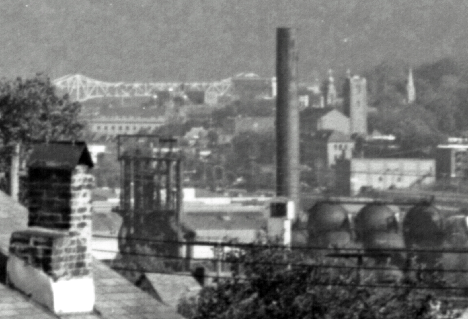

All right. A test was made. Hand held verses tripod held. Same film, time, location, settings. F 16 1/100, then f22 1/100 both hand held. Then the same thing was done on a tripod. The scene was a very long landscape city shot. The light was bright sun from the left in the morning. Slightly hazy. Scans will be one tiny area the same on each negative in as high a dpi as I can do. 4800 I think. No plastic sleeves. The incident light was exactly half way between 160 & 320 with the high slide in on a Sekonic Studio Delux light meter.
Three shots remain.
BTW do not use Gaffer's Tape to cover the ruby window. It pulled it out!

1/100 f16 hand held on top, tripod held on bottom, 4800 dpi, 6x9 120 Arista 100 film.

What scanner are you using? I ask, because none of the flatbed scanners are capable of resolving anything close to 4800 ppi. Usually the optical maximum is somewhere around 1700 ppi, with the rest being supplied by software interpolation.

Studio, they both look pretty fuzzy at that degree of enlargement, cannot see much of a difference.

Anything more than 1200 ppi with that scanner is liable to distort the results of any film or camera evaluation you are trying to accomplish.

The only difference I can see between the two is that the tripod version has slightly lighter tones... but that could just be from scanning.

At 1/50 there may be a difference. The lens is 105mm and those photos were shot at 1/100 according to the handheld rule. Even so, I managed to blur a 1/100 shot handheld.
