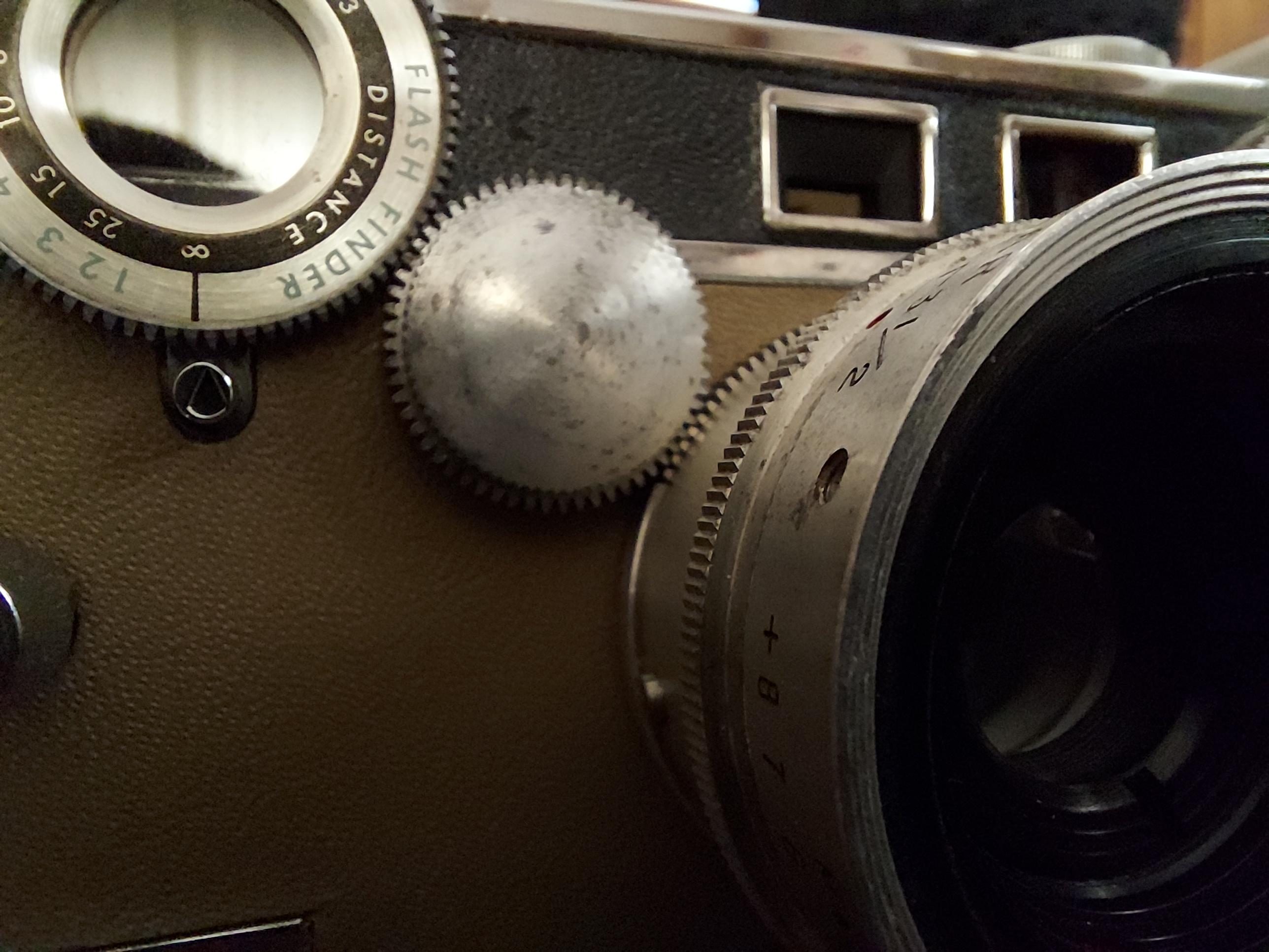

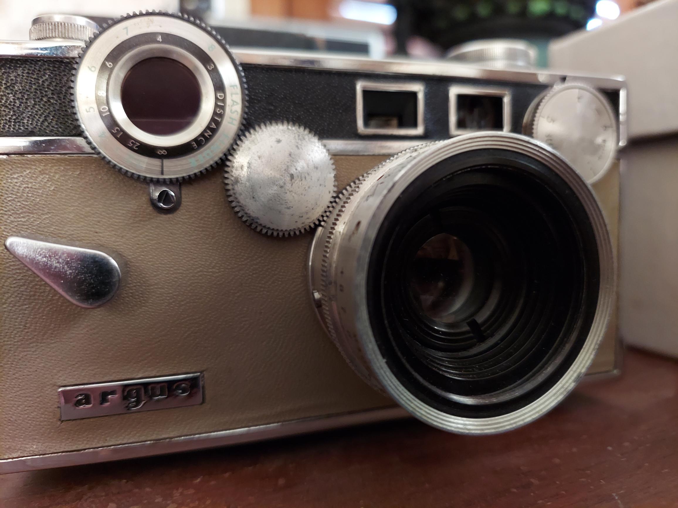

@momus is right. You might take a phone photo of the camera (make the shot showing the lens and threads at infinity, etc.. Those who have a C3 can compare to theirs and can tell if your lens is off a thread.

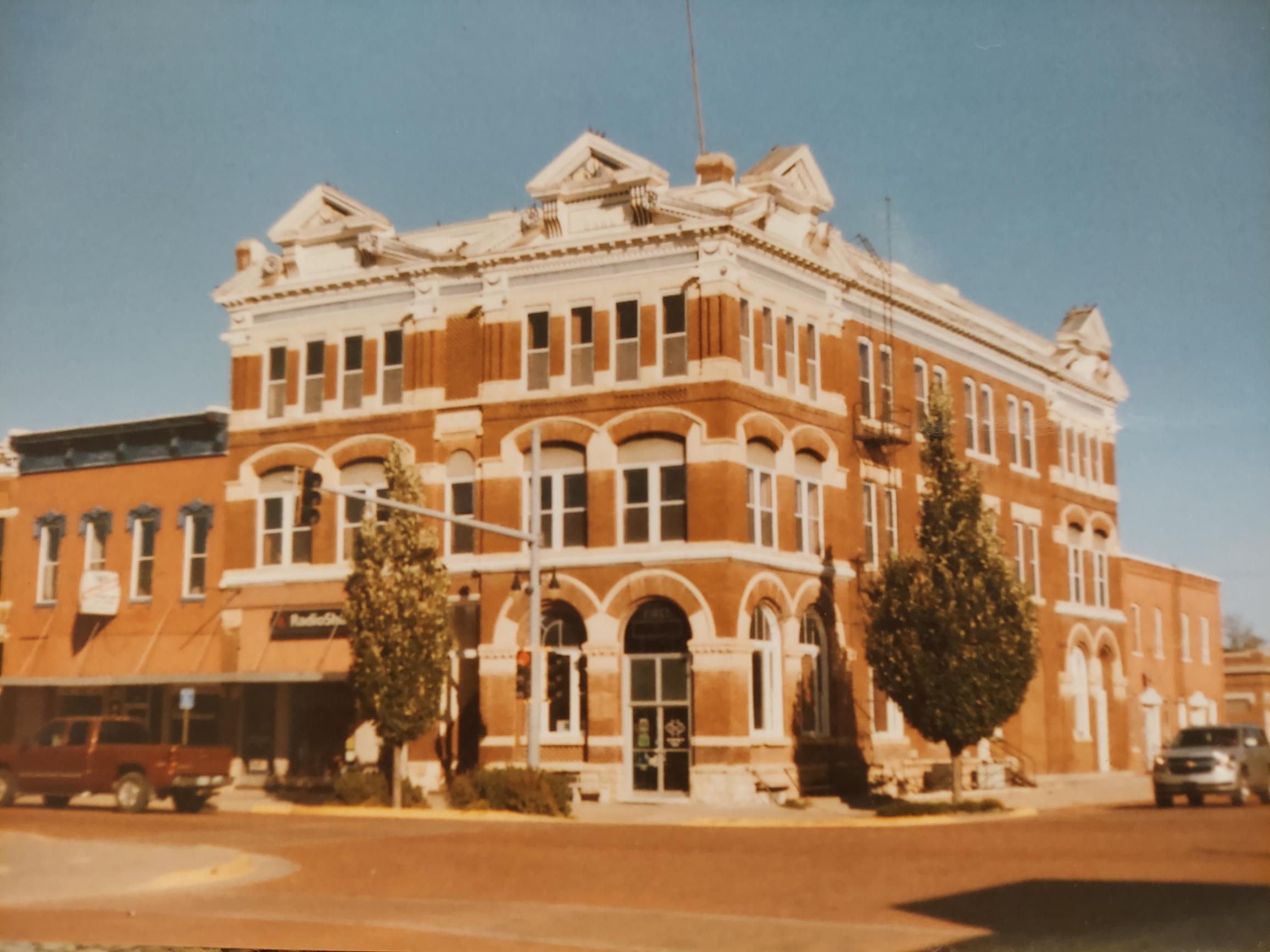

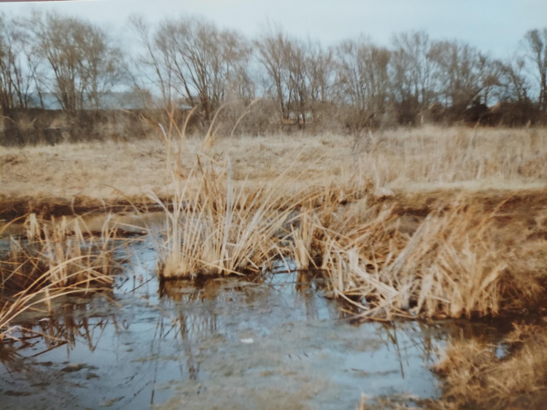

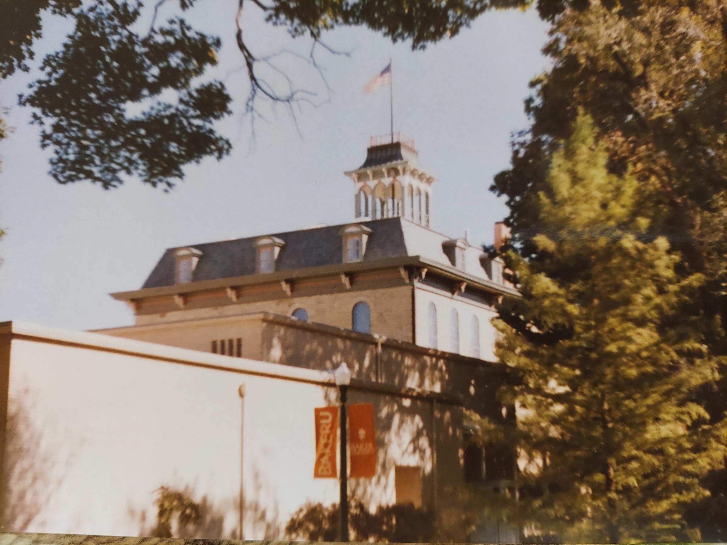

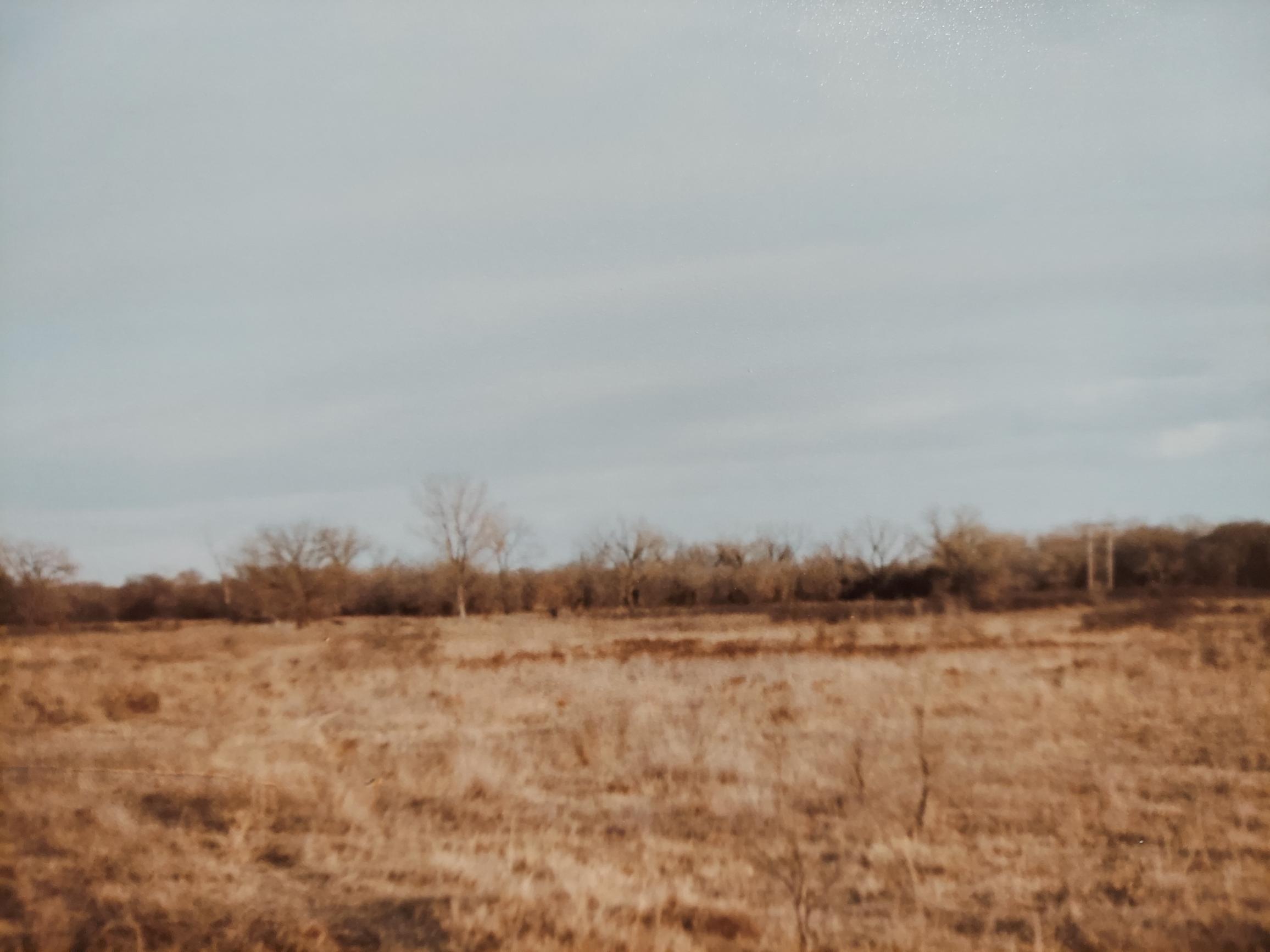

Brian, the matchmatic uses exposure values, so I do not recall what ISO or f-stop I would have used even had I remembered to convert from E.V.'s to standard and write it down. I will remember that for future camera rebuilds. Anyhoo, here are a few pics for you. These are just randoms. The buildings were all handheld, the scenery shots were all on a tripod. 20220327_151258.jpg20220327_151232.jpg20220327_150844.jpg20220327_151136.jpg
Momus and Bill, Hopefully these two shots are what you were referencing, and will help in the solution. I kind of like this camera. Although it has been mildly challenging getting used to exposure values, once I figured it out, it is fairly quick to set up to shoot.

I have an earlier version of the C-3, but I suspect some of the internals are similar if not totally identical. One hazard is the focusing helical is actually multiple threads (I'm thinking 6) so if the lens barrel is disassembled far enough, it's possible to start the focus assembly on a number of wrong paths. That is where the idea of using a ground glass or Scotch tape becomes useful. I have also produced a ground glass sufficient for a quick check by wet sanding a piece of acrylic glazing with something like #220 wet-or-dry paper. I noticed in the 2nd(?) picture, some blades of grass in the lower left foreground appear pretty sharp, so the good news is the blurriness is likely mechanical positioning ("calibration") as opposed to oil on the glass or hunks of 'stuff' in the optical path.
