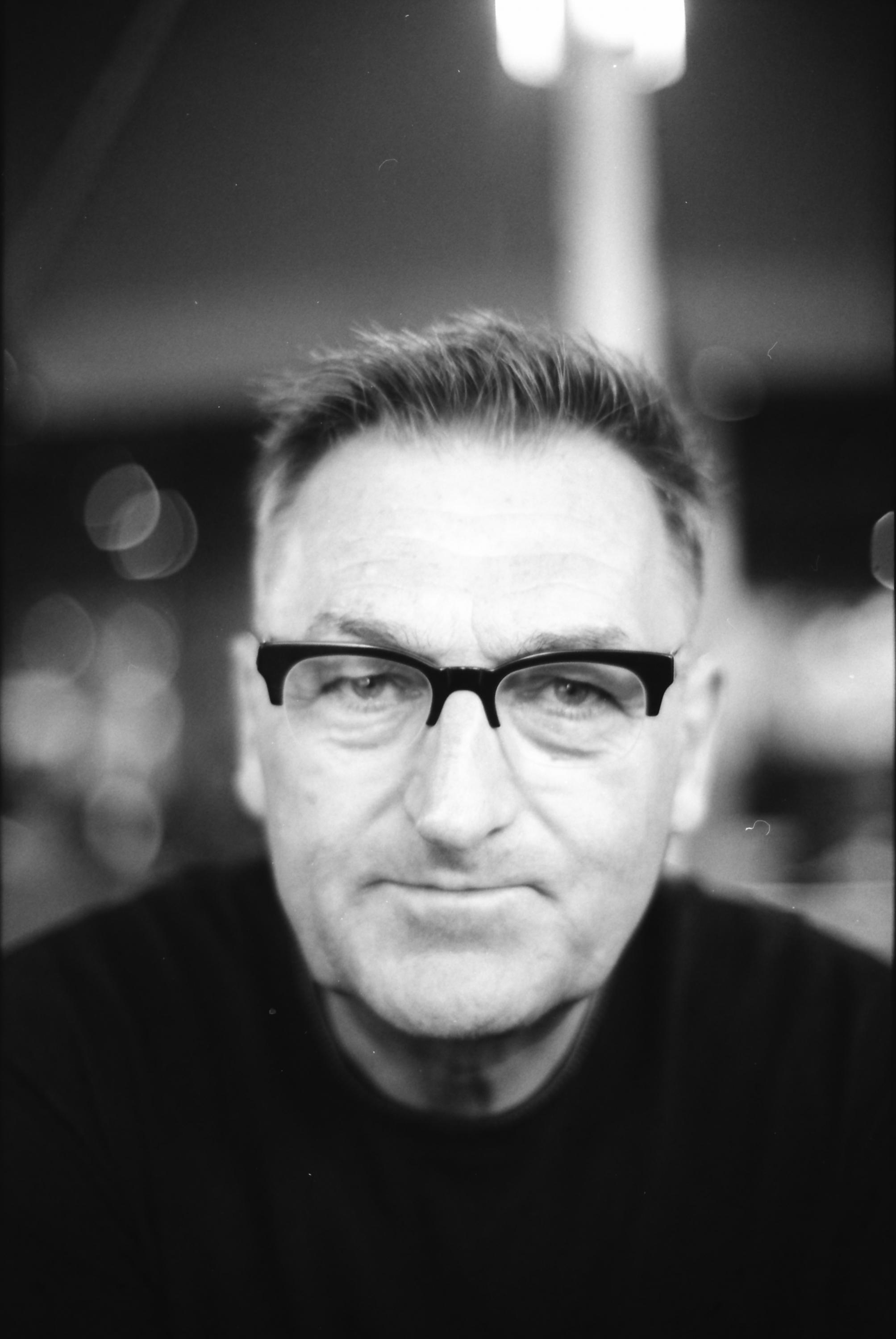

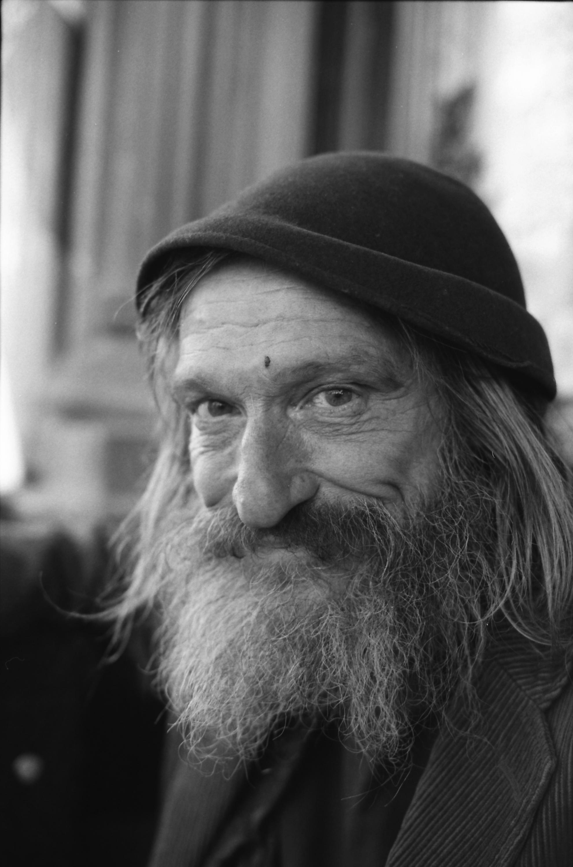

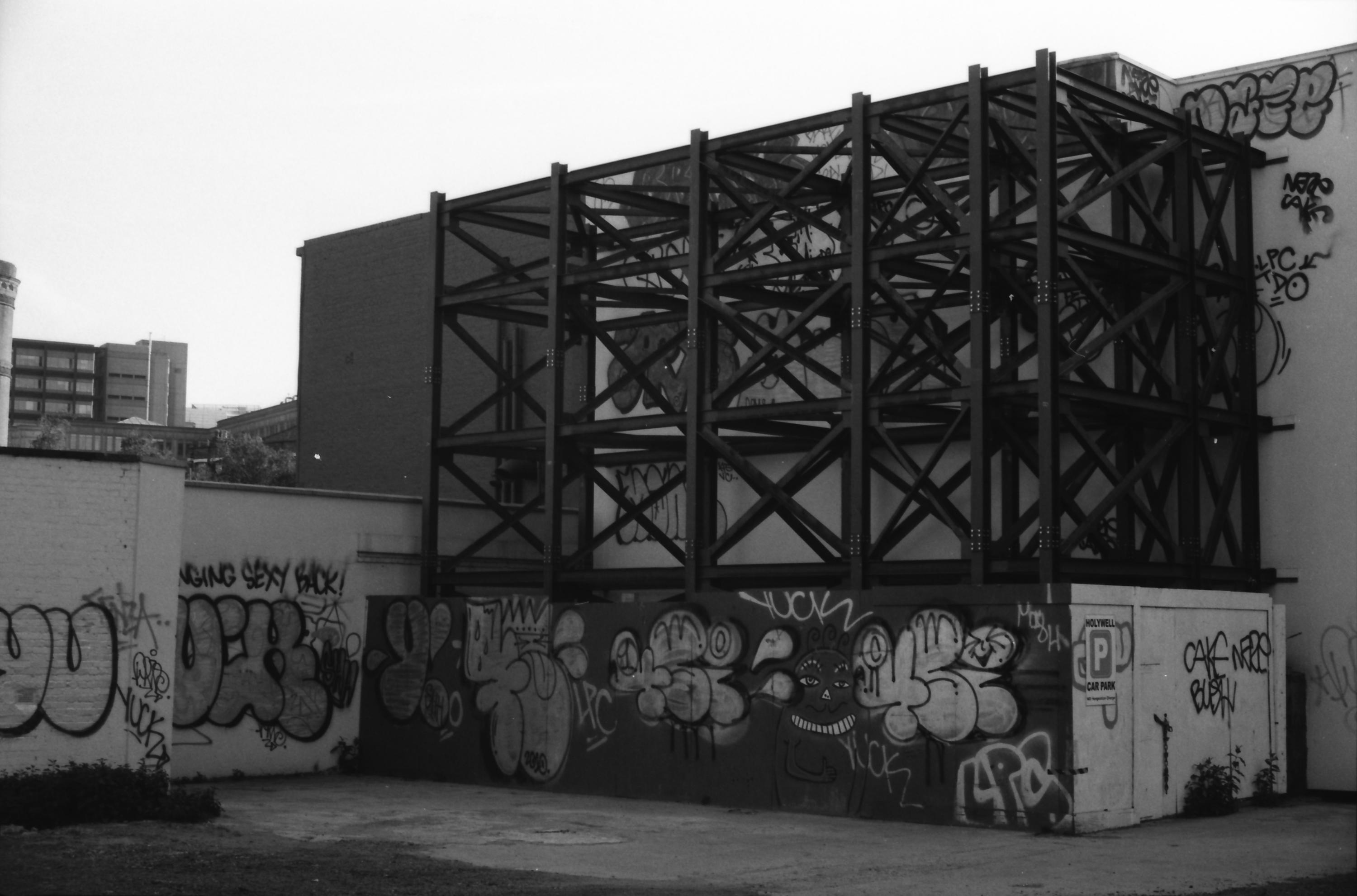

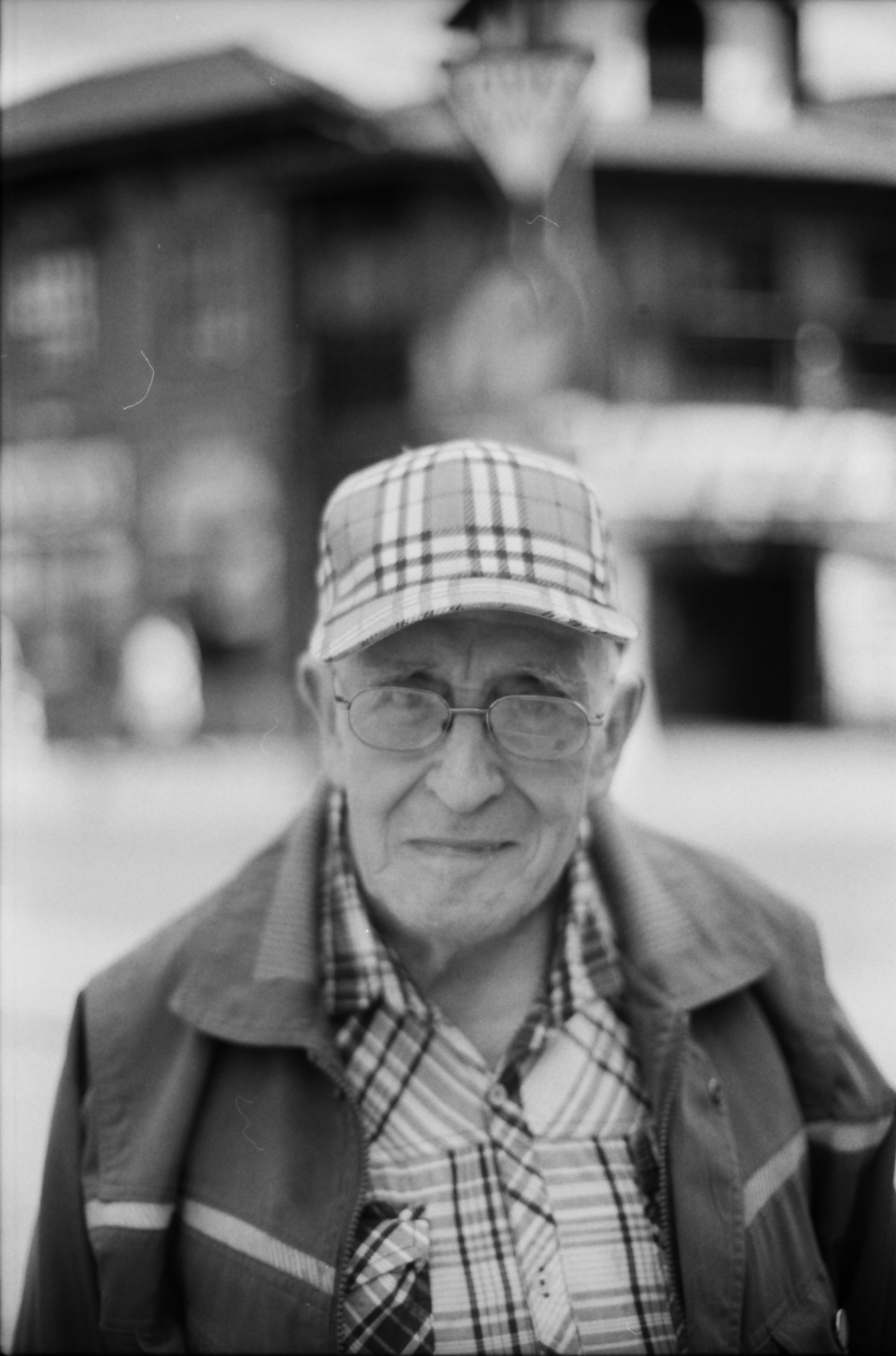

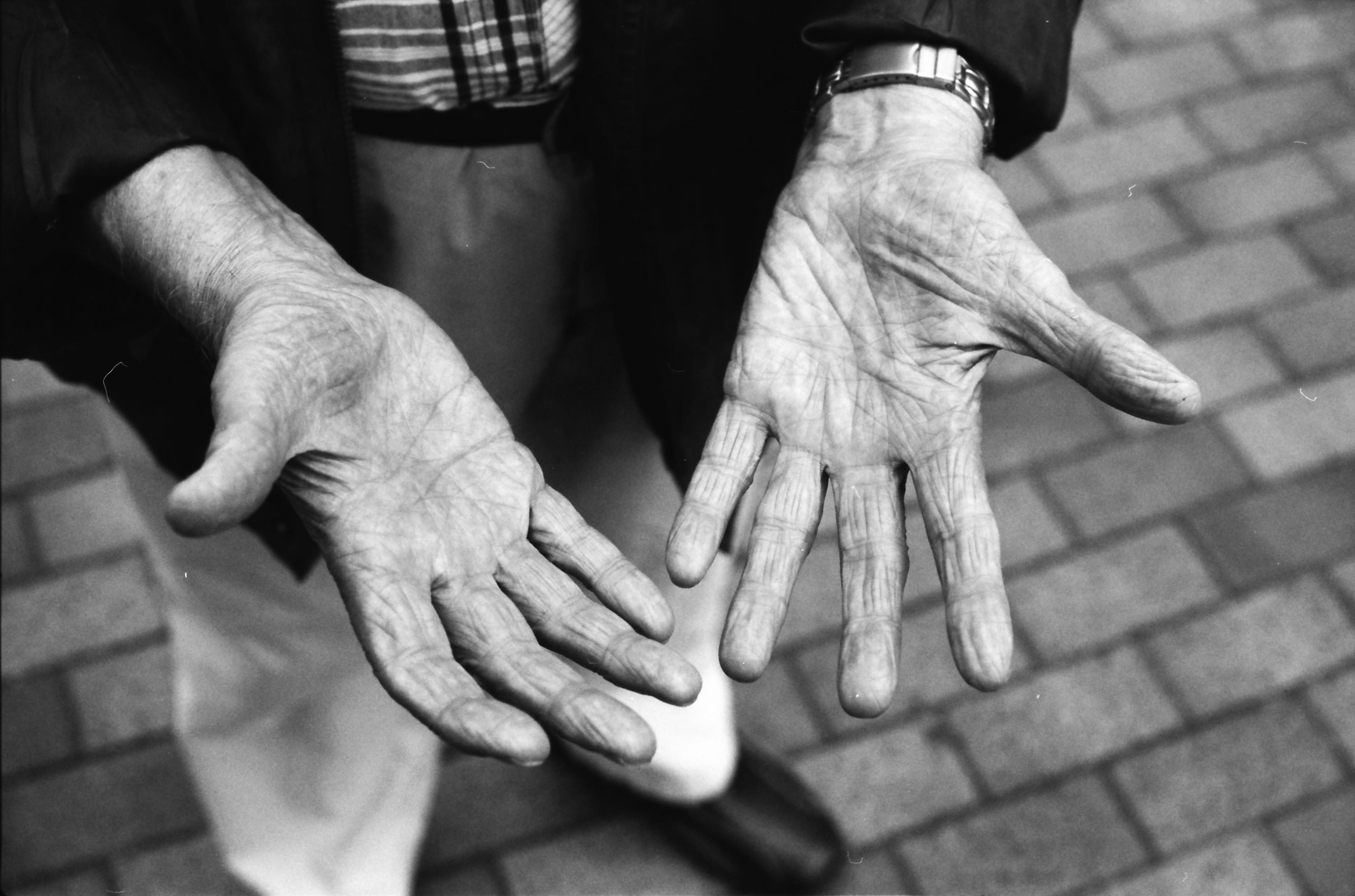

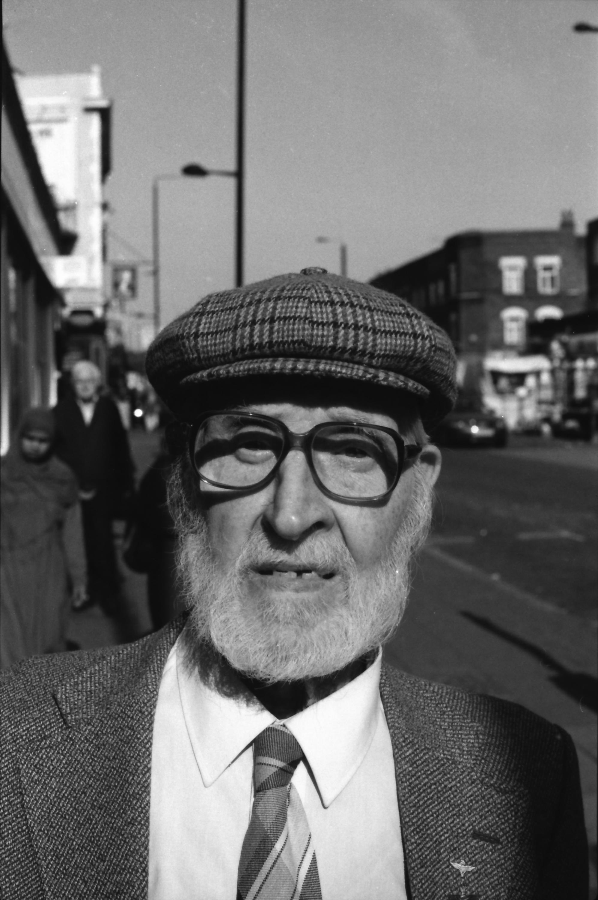

This was my first try at developing everything from scratch myself.
Back in college a couple months back, we used ID-11 at a ratio of 1:1. Then stopped and fixed with some generic Ilford Stop and Fix (I was too caught up in picture taking to worry about developing chemicals back then). The results came out fine... I was always happy with them and assumed that all developers develop very similarly with only slight changes in contrast and tone.
The first three pictures here are how they came out from developing in college. The last three are how they came out in my bathroom using Ilford HP4+ developed in Infosol 3 for 6:30 as per instructions. 30 sec stop in ilfostop and 10 minutes in the rapid fixer. 10 minutes in running water afterwards with a little drop of fairy to avoid watermarks.
They seem very too different to me, the ones developed with ilfosol 3, the portraits seem washed out and lacking detail whereas the portraits that were developed in college seem much better to me.
I was just wondering is this was normal for Ilfosol 3?
Many Thanks

The last one seems full of detail. Some differences are due to shallower depth of field in #4 and #5.
Jul 27, 2010
257
Memphis, TN
Great portraits, and congrats on developing at home! Yes, your results are indeed typical of Ilfosol 3. If you're looking for less contrast and finer detail, try using the 1+14 dilution, or a finer developer like D-76/ID-11, Ilford DD-X, or Rodinal.

Yes, the last three look like Ilfosol 3, and I like them better than the first three. I do tend to be very generous with time when using Ilfosol 3. I don't start timing until the tank is full, and don't empty until the time is up. Probably adds 5-10% to the time. Works for me.

The portraits are punchy and have a good impact factor. If I'd been asked to comment on them more generally (without your specific question regarding Ilfosol), my thoughts would have been a) you have a bit of a problem with dust particles, b) watch out for what's behind the subject (verticle posts in two cases) and c) to my eye, shots 3, 4 and 5 have too much headroom, though of course that's subjective and perhaps a case of convention vs. personal style. Please take my comments as they are meant - in a constructive way. My favourite is no.2, which doesn't invite any of my comments above!
