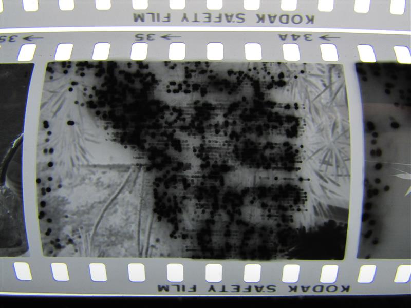

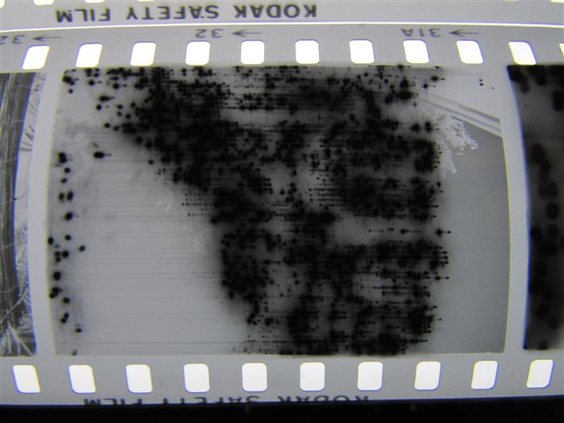

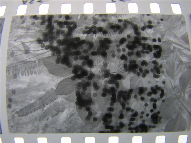

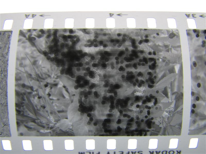

Shot two test rolls in a new to me Canon IIb. All the frames seem to have measles. The lens (Serenar 50mm 3.5) is clean, with only normal internal dust, and that's checking with a flashlight, so the only other thing I can think of is pinholes/deterioration of the (1st) shutter curtain. Because of the Barnack design, I can't just hold a light on the other side of the shutter, so I turn to your expertise.
Some examples of the frames (every frame has the same pattern, and some are worse then others):

it is fascinating how, on all three frames, the dots follow the same general pattern...I am betting that, yes, sadly, the curtain -- which on that camera is probably a mere 70 years young -- has rotted out, and if you could put a flashlight flush against the base of the camera with the bottom off so some leaked up into the film area, you might see it in a dark room with the lens off.
bummer. perhaps youxin ye can replace? Certainly worth it.

That's what I was afraid of. While the cost of the material is certainly cheap enough, I don't feel comfortable doing the repair myself after reading up on it. And to have the repair done by a reputable repair person is cost prohibitive (around $400 from what I can figure, as it would include a complete CLA, etc.). It is a shame, as the shutter speeds all appear to be spot on, (based on what I can see in the negatives), and the camera really is in great condition otherwise.
I'm tempted to give it the fabric paint or liquid rubber treatment.

I'm going to try and paint the shutter, using either fabric paint or the liquid rubber stuff. The curtain fabric looks to be in good condition (no holes or tears), but the original(?) rubber layer is missing for the most part. In the images above, the areas where the dots don't show corresponds to where the rubber surface is still present, so it's definitely the curtain. I've read up on it quite a bit, and it seems that there are quite a number of Leicas that has had their shutter curtains 'repaired' with the paint method, so it should be good for a few years. We'll see how it goes.

No. Most of the time shutter curtains stay in place. In a rangefinder camera there's not even the mirror on front of them, so all light ends up on the film through the pinholes. In older SLRs without auto-return mirror, such as Exaktas, this is very evident too. Even if the SLR had an auto-return mirror, pinholes still tend to exhibit themselves like this as mirrors aren't usually light-tight.

Them is pinholes all right. I used plasti dip on the Leica 3 I got from Goodwill, fixed them up pretty good, the only bad thing is that the 1 sec speed is now a bit long. All others were and are still perfect. The reason I did it on such a nice camera is because I know I will be replacing the curtain at some point, and now I get to wait until something else goes wrong.
