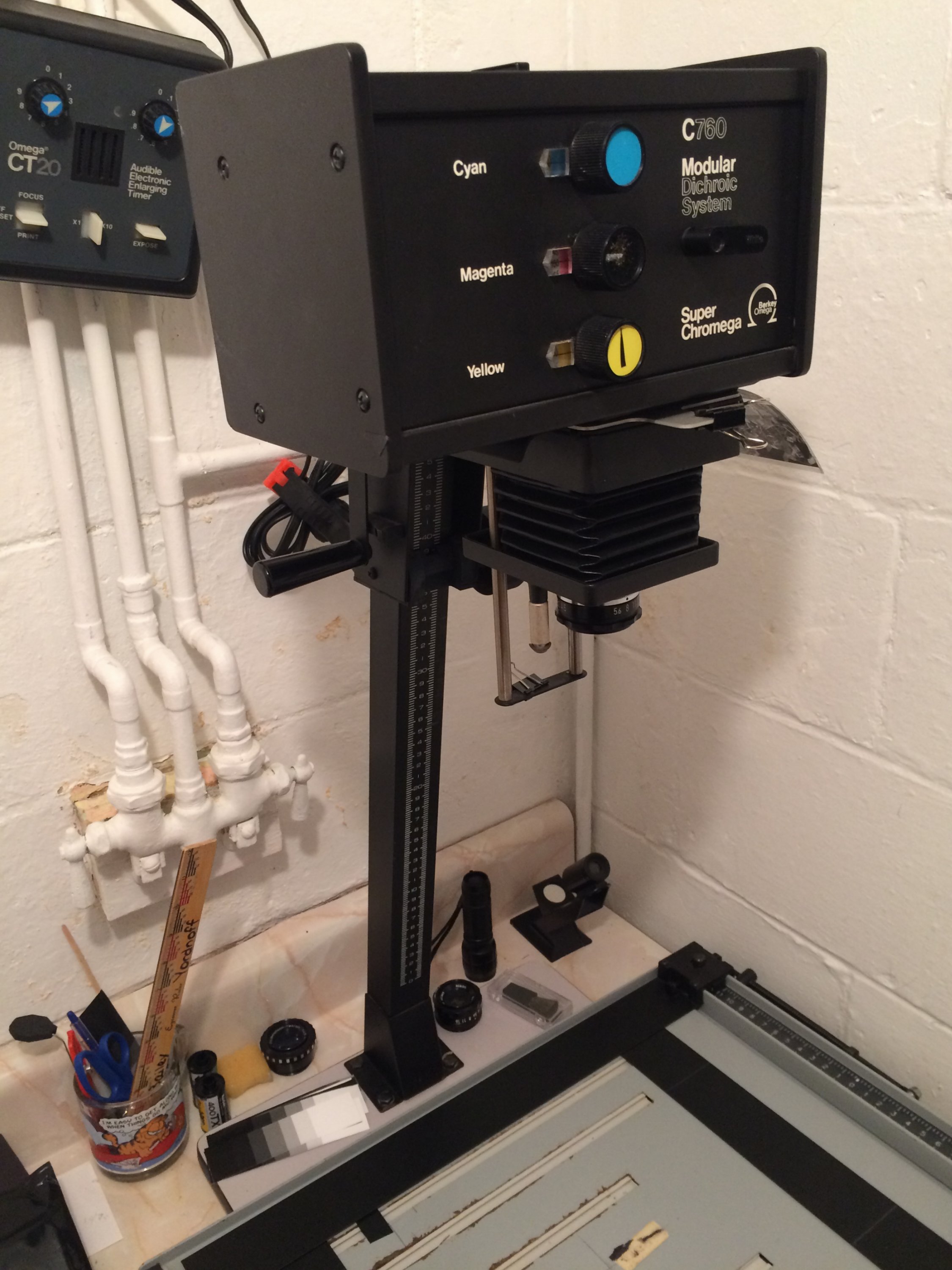

Is your C-760 head mounted on a B-22 chassis? A picture of the machine might help solve the mystery.

I wondered about that. Don't know if these help...
View attachment 173281 View attachment 173280
I believe that's a B600 chassis. Not positive, but pretty sure.
Those Omega B and C color heads are basically flat on the bottom, but the chassis will vary. If you look closely, I bet you'll find the chassis has 2 pins with engage with those 2 cutout areas on either side of the hinge in the carrier.

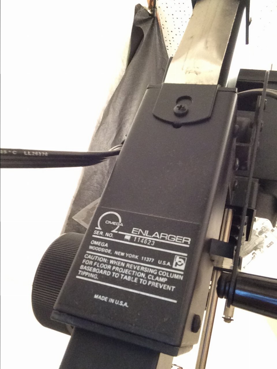

Thanks for taking a look, everyone. Is the model number (of the chassis) not anywhere on the unit itself? Clearly, from my photo, it's not on the back plate (except to say Omega).

Is the opening in the frame the negative carrier rests square or rectangular? Square would indicate this is a 600 series chassis.

Mystery solved. It's a C-700 chassis. I forgot that the enlarger came with the original manuals, of which there was one for the C-700 and one for the C-760 dichroic head. Thanks for taking a look. I need C-700 carriers, which work with the B-22, -66 and -600 enlargers, but not the C-760.
