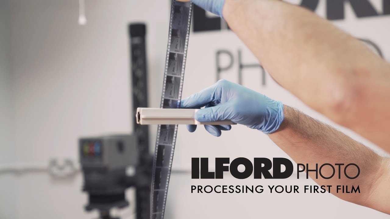

I know this is what you don't want to hear and others will raise hell at my suggestion BUT would you try a squeegee?
I mean a proper squeegee, properly used.
I have used one professionally for 35 years and never damaged, gouged, or scratched a film. AND I never had drying marks.
Believe me, it can be done but it must be done properly.
Just sayin'
