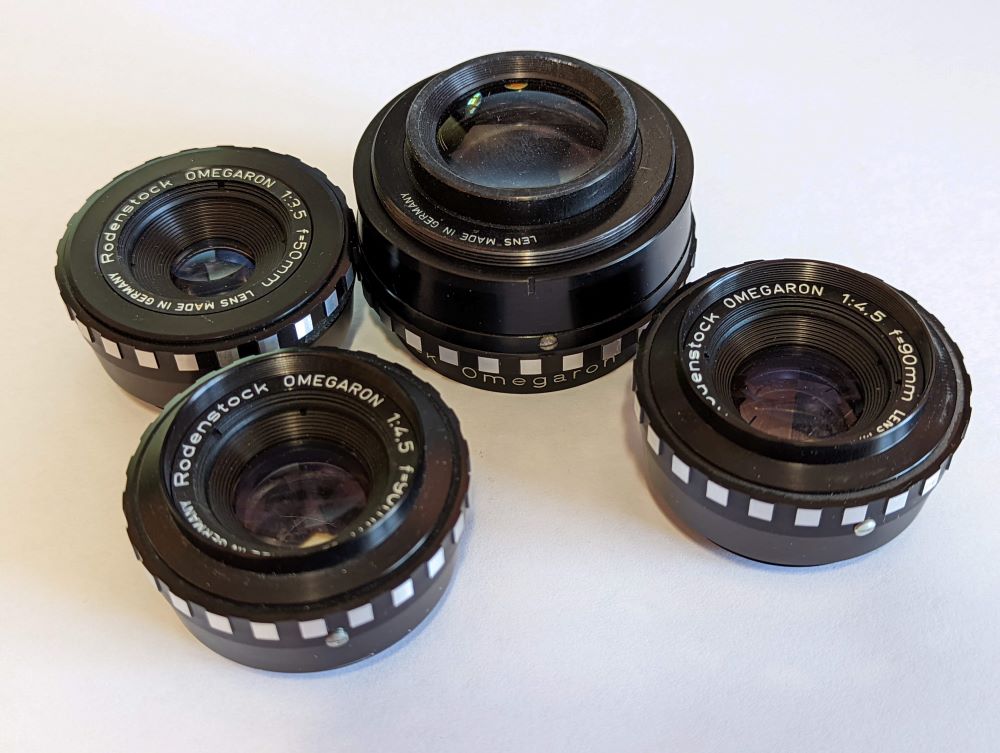

So everybody else has a box of enlarger lenses too? I had the impression that Omegaron were good lenses but I often defer to others like Componon-S etc. It would be good to have a purpose for these lenses based on certain types of jobs.
