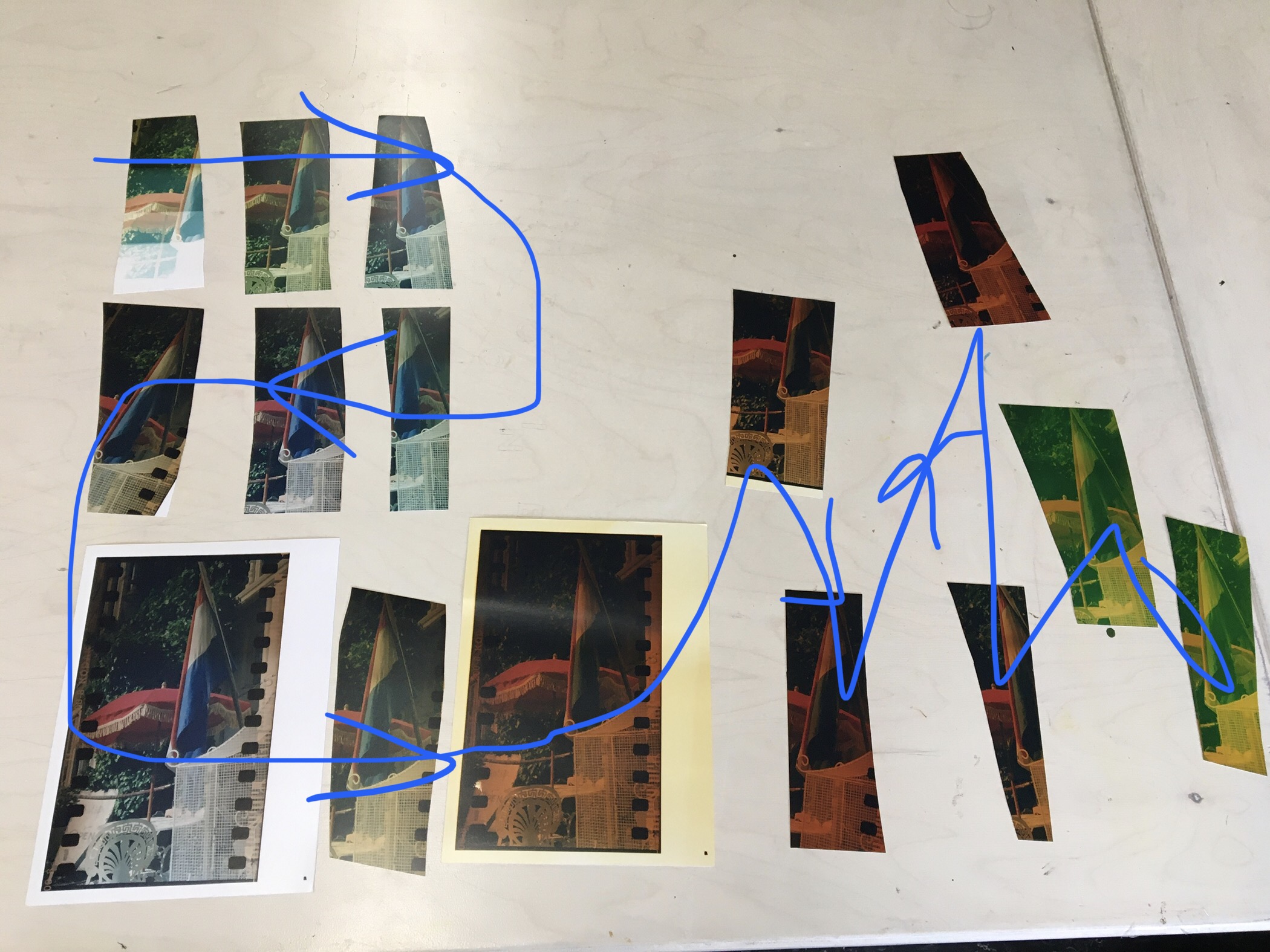

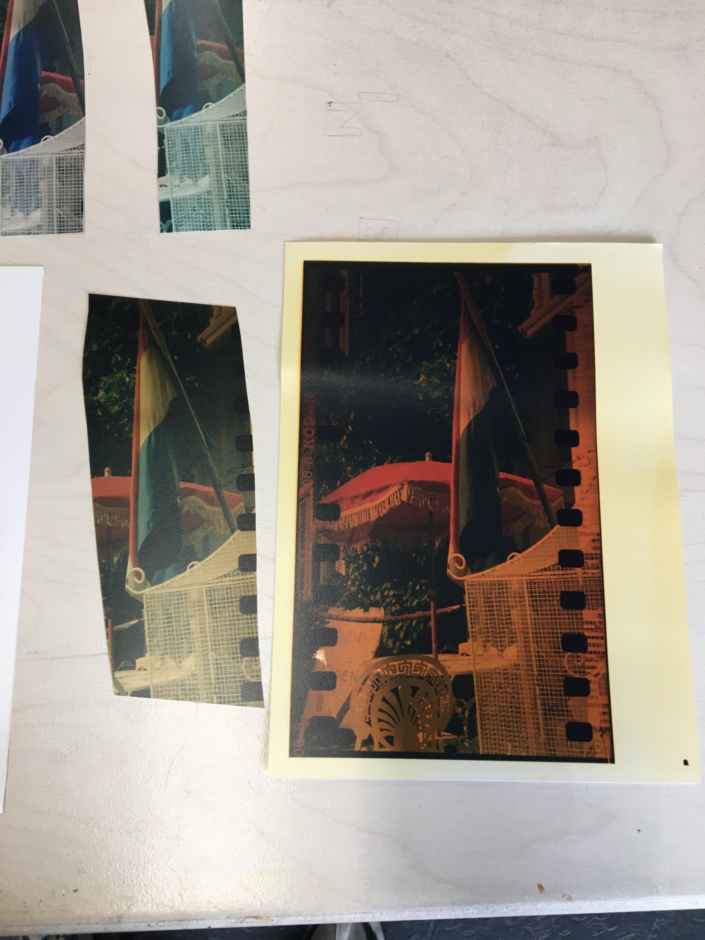

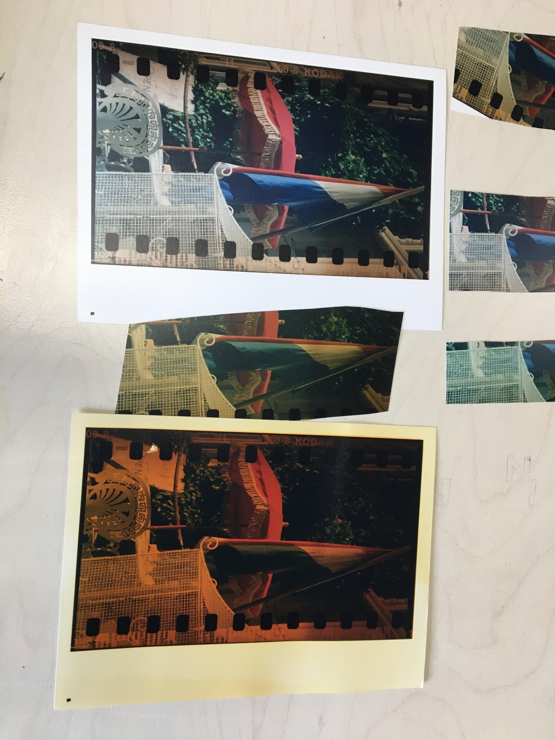

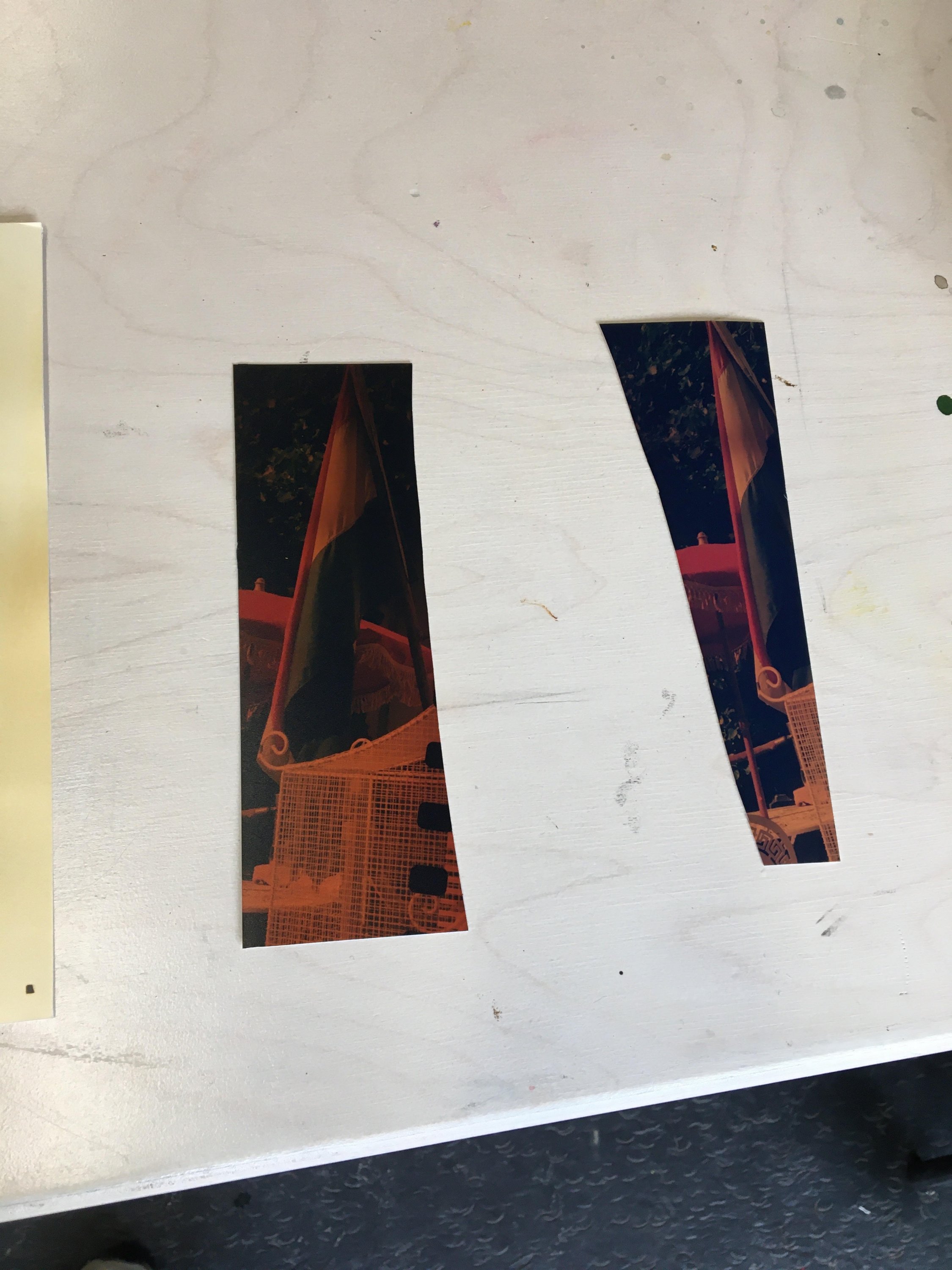

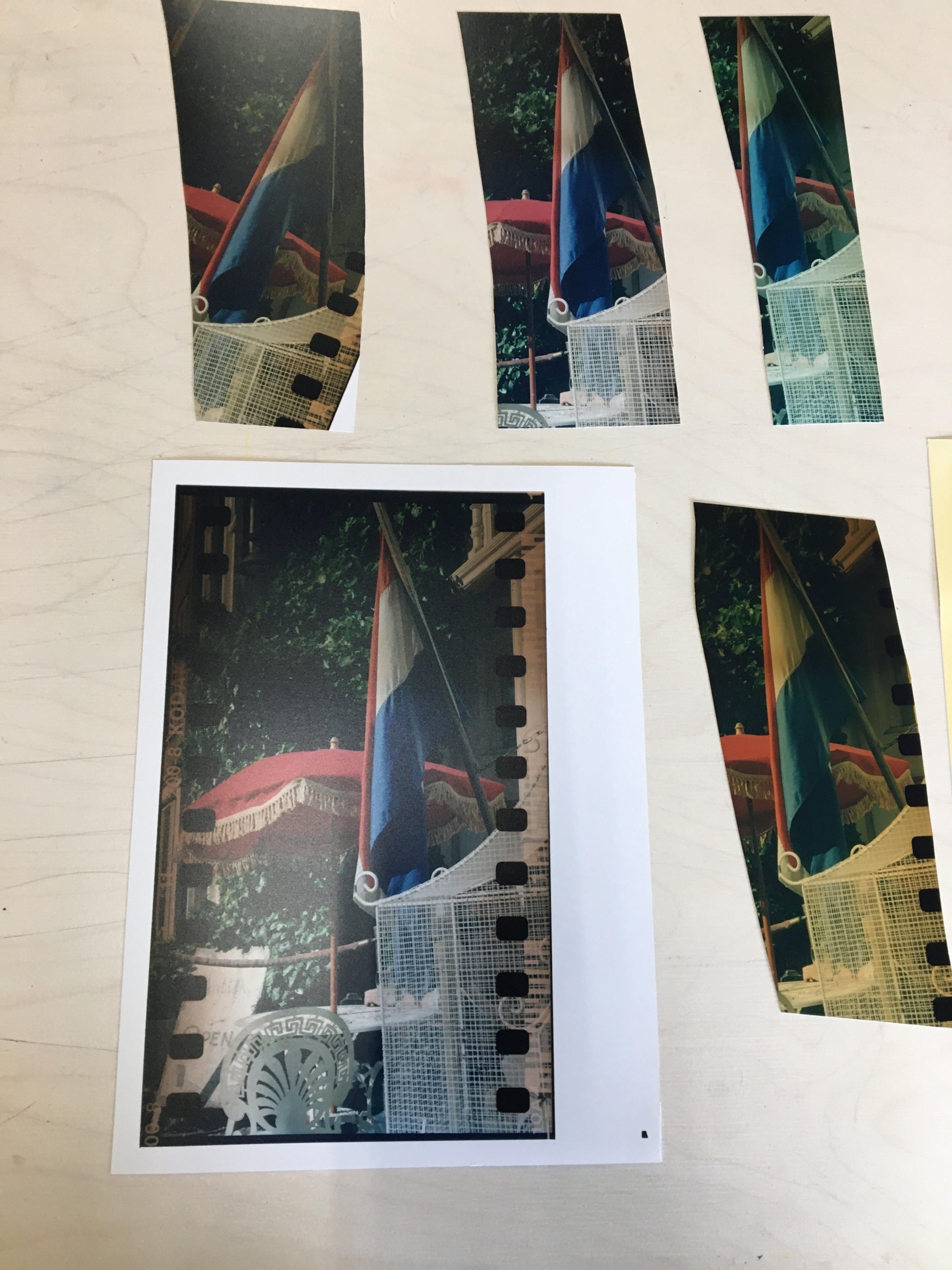

I am in the midst of a color darkroom session using a durst rcp-20 machine. This is my 4th time running my machine, but all of a sudden my (test) prints are turning reddish. I also notice the unexposed border is not white but orange-ish.
I am trying to come up with an explanation and I hope it's due to chemicals gone bad??
Here's my process from tests to almost final print and than all of a sudden "red orange". My time in the darkroom from to left to bottom right is my last test try.

Maybe some blix got into your developer. In your place I'd mix up a small batch and verify if it works ok using trays, if yes, scale back on the rcp.

Tx, I already clean up ......... and to my horror the stop bath was empty :sad: ...... seems I had turned the "crane" of the stop bath and it was open. I hope I haven't ruined the RCP thermo part :sad:
Going to my darkroom in 3 days again. What's the best way to check if I ruined the thermo part? put in water in all 3 baths and wait for 30-45 mins??

I'd just put water in it and see if it comes to temperature and stays there, yes.
I don't think it's the cause of your bad prints though.

btw this was my printing timeline this afternoon:

Looks like were in the same country :wink:
Also looks like something went wrong fairly suddenly, so cross contamination is certainly not ruled out.
