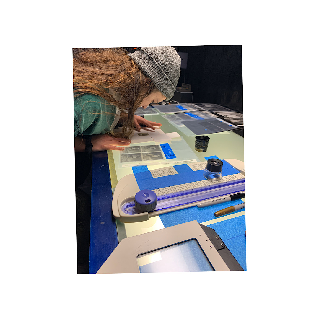

I use a paper cutter, not the guilitene ones, the ones that have a sliding cutter.
I tape that to my light table at the distance from the edge that I need for the long side.
I make a stop with several thicknesses of tape for the short side.
I put the roll to my left, unroll several feet, slide it under the bar for the cutter to the edge and cut five or ten or so sheets.
Then I rotate them and cut the short side.
In the dark.
I keep the roll in the light tight paper bag that it comes in, and make sure to tape it up well with painters tape before I turn the lights on.
It's pretty easy.
