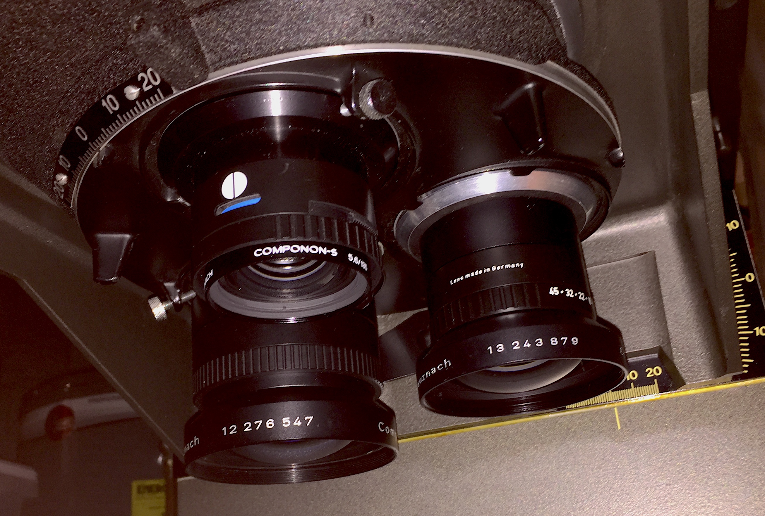

Most enlarging lenses have the so called "Leica" thread, but the deeper you dig the more variability in mounting can be uncovered. Especially with e-bay, where the seller is more-often-than-not, ignorant of photography, one can easily purchase an enlarging lens nearly impossible to mount on one's enlarger.
For example I spent years looking for 3 matching Componon-S lenses to mount here (designed originally to mount "non-S" Componons).
BTW, nothing wrong with "non-S" Componons, but all the examples I own or could locate, have fungus, separation and scratches; usually all 3 on the same lens.
