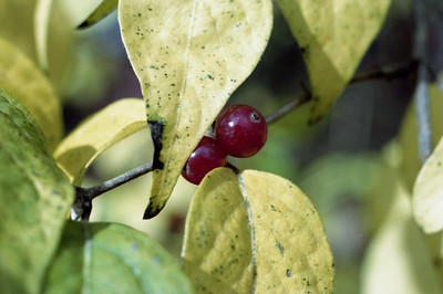

I've been doing my own C-41 for six years or so. I've always used the Unicolor powder kits because of the price and my belief that dry powder will have a longer shelf life. (I say Unicolor, but based on the identical nature of the instruction sheets I think they're the same kits sold by Freestyle and FPP.) These are easy to use and the chemicals stay potent much longer than the manufacturer's specs imply. The oldest color film I've developed was some Agfa XPS 160 from 2001; I developed it normally with no compensation and the results were good but with some green shifts (correctible in post). I am nearing the end of a bulk roll of Portra 160NC that expired in 2009 and just beginning to see some color shifts. The only case where I use compensation in dev times is when I get near the end of the useful life of the developer--compensating for exhaustion rather than age of the film.
EDIT: Here's a recent shot from that roll of Portra 160. The reds and yellows are slightly muted but manageable.
