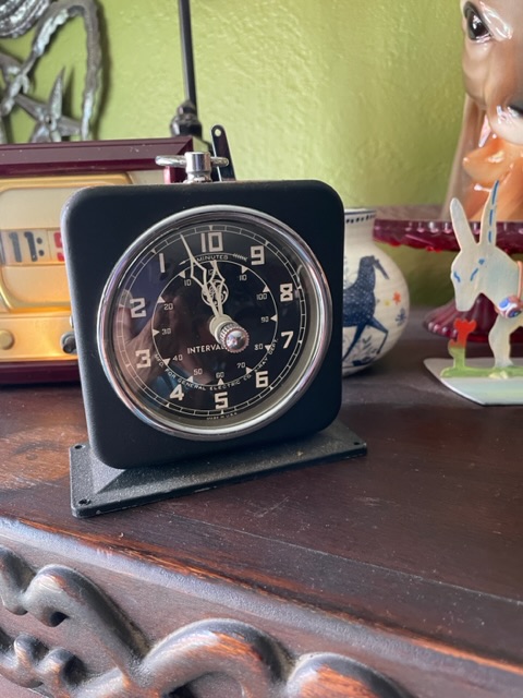

GE Interval Timer is great if you can work with roughly 15 second time marks.
It’s great for outdoor uses, set the time, lower the arm (which charges the bell). When the minute hand hits the top the bell rings and the arm lifts. You can tie the arm to a flag or maybe a switch.
These are cheap and plentiful.

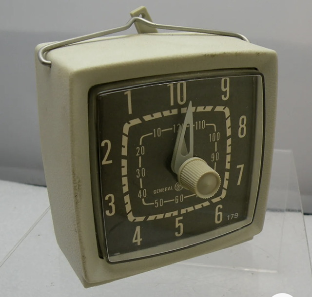

This plastic variant is mechanically the same.
The bell is loud and a flag would be just what you want…
I think you would want either this or the black metal one like mine.
Set the dial at 1… when you see the landmark yank the flag… when the bell rings and the flag goes up you know it’s safe to turn.
