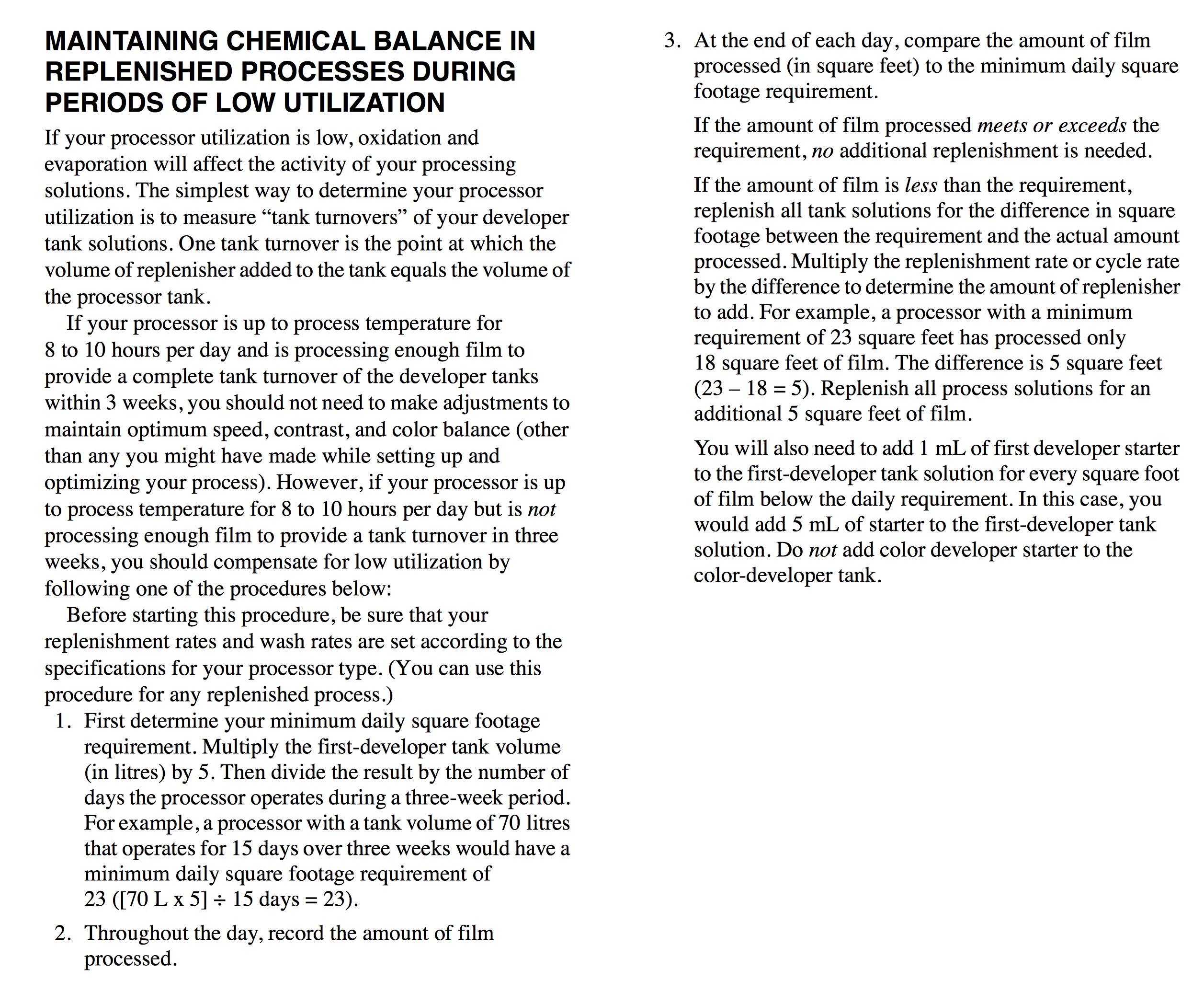

Also, does anyone know of a scientific way of determining if a chemical (developer/fixer, etc) has been exhausted? I’m trying to figure out what other types of sensors I can hook up to the controller (such as a PH sensor and the like) to be able to monitor specific attributes of the chemicals so I won’t need to guess if they are still good or not?

Technical bulletins of the chemistry should be able to guide you in replenishment process control. Here is some info for Fuji RA-4 replenisher.

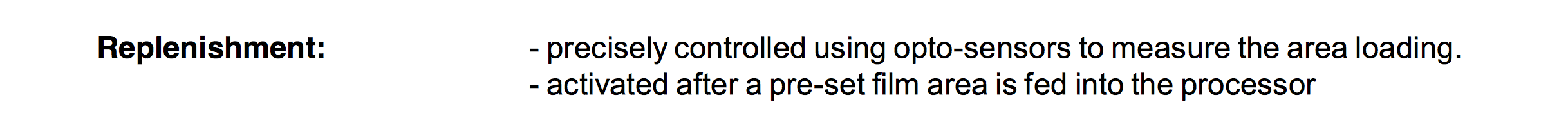

How the Colenta processor does it:
