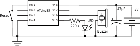

Here is a little metronome timer I put together based upon the ATTINY85 microcontroller, The timer runs off a single 3-volt lithium battery. It turns off automatically when not in use.
The timer starts when the button is pushed AND released. A beep from the piezo speaker on release of the button can coincide with opening a shutter when doing long exposures for wet plate or pinhole work.
The timer ticks and flashes the red LED on each second thereafter. 15 second intervals are marked by a longer beep.and flash. 10 seconds before three minutes, the timer gives a series of 10 warning beeps before an alarm is sounded and the timer shuts itself off. The three minute length was chosen as it is ideal for timing the silver nitrate bath for wet plate work.
The timer can be turned off at any point by depressing the button a second time. The timer then resets for another interval.
The circuit is quite simple:
The Arduino code is equally simple. You must install the ATTINY85 board files into the Arduino IDE and use a simple programmer to get the code into the chip. The timer uses the internal oscillator of the chip, which can be quite inaccurate. The code contains a calibration factor that trims the oscillator for accurate performance.
I have the precompiled .hex programming file listed below the source code.
This is for those already familiar with Arduino programming. It may be a bit daunting to come up to speed on all of this from scratch!
Regards,
Don

Sorry to say, there was a small bug in the code. If the timer went to completion and powered itself off, TWO button presses were needed to start it, I forgot to reset the power state flag when the timer turned itself off after 3 minutes.
Here is the corrected code and hex programming file. Sorry for the "oops".
I also packaged mine up in a small enclosure with larger button.
Best,
Don
