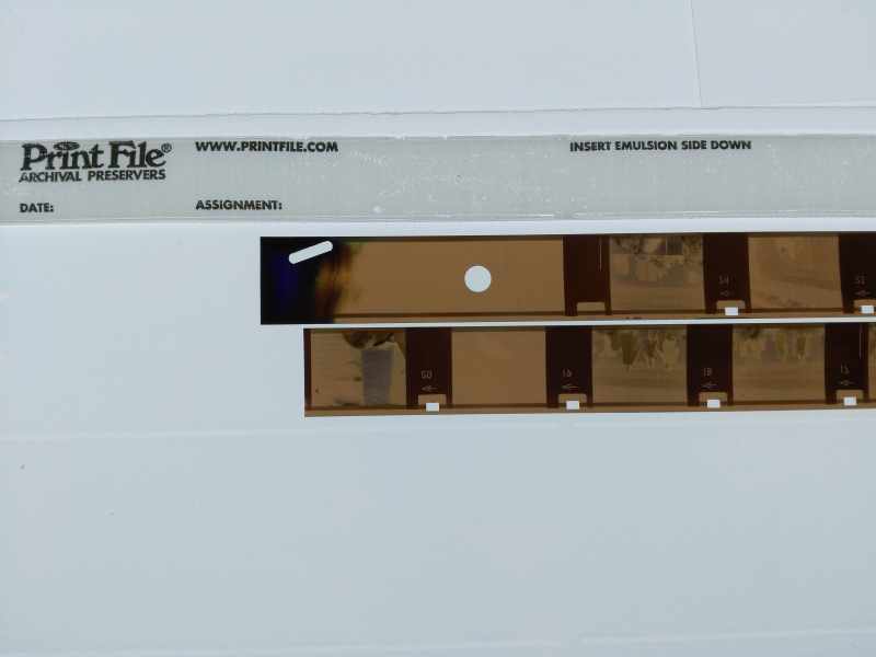

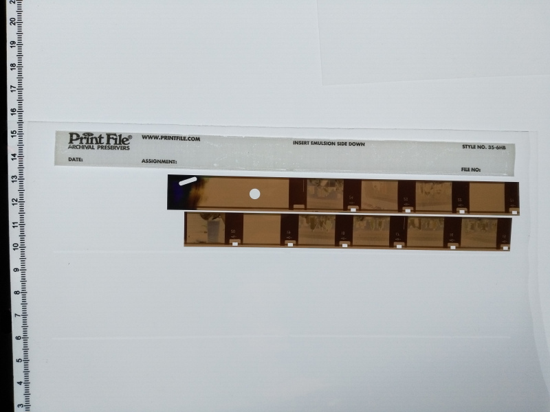

I'd not even worry about sealing the Printfile Pages. I have the 6 Frames x 6 Strips 35mm pages that Donald mentions and two strips per line fit easily enough and, whilst a tad fiddly, will stay put once placed.
Forgive the quick mobile phone snap:
