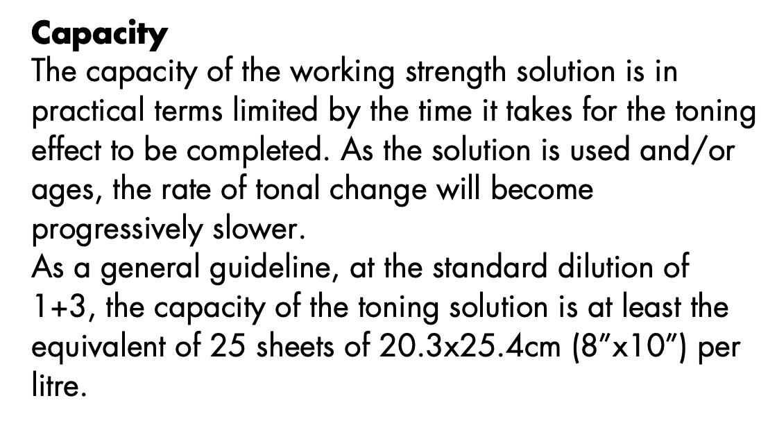

Selenium increases Dmax 🙂 but is toxic 🙁.The product from Harman has a capacity of 25 8x10 prints and costs $39.
Cost: $1.56 per 8x10 print.
Your math is way off, as you did not read the information correctly. At 1+3, with a 1 Litre bottle, you can make much more than 25 8x10 prints, as you don't need more than 500-600ml liquid total for that size. Moreover, since you are only looking for archival quality and not color change, you will probably use the 1+20 dilution, which will increase even more the number of prints you can make with one bottle.
The instructions that you posted say "at least 25 prints". That does not imply that you can make "much more than 25 prints". I'm not saying it's not true; I'm saying that that's not what the information sheet says. So the problem was not in my reading. [edit: I was wrong]
In any event, I concede your point that I did not include an option for the 1+20 dilution. I could have included a "no toning" variation of selenium at 1+20 and that'd bring its cost down to the same ball park as sepia (but again, without the toning).
Yes, even mixed 1+3, you use 250ml of concentrate to make a litre of working solution. Assuming a minimum of 25 prints per litre (depending upon the particulars of the print) The cost is as follows:
$39/4 = $9.75.
This treats 25 prints, so the maximum cost is $9.75/25=$ 0.39 per print.
You missed the fact that the diluted toner is used for the calculation.
A litre bottle makes 4 litres of 1 + 3 working solution.
Each of those working solution litres is enough for 25 prints.
Oh! Crap! Thanks for the correction.
Yeah. I absolutely did not realize that. @Alex Benjamin was right. I did not read the information correctly. I thought "toning solution" was just a term for "the solution in this bottle", but the previous paragraph makes it clear they're talking about the working solution.
