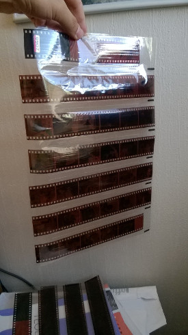

As my pile of negatives keeps becoming bigger and bigger, need for good archival is something I'm waking up to. I do know I ought to archive everything in acid free binders/boxes, but there's one even more urgent question I have as most of my negatives were processed in labs: in order to put my negs in some ring binders, do I have to (or should I?) remove them from the sleeves they are now in or are there larger ring binder pages available in which I could slide these existing sleeves to without taking negatives out first? Replacing all existing sleeves with ring binder page archival sleeves would be rather big project, not to mention the greater risk of scratching my negs...

The sticking point is that you do not know if the negatives were archivally processed. You will need to test each roll of BW film to look for residual silver and thiosulfates. Color negatives are usually OK as they require less washing and are stabilized.

In the end I decided to ask my lab about those sleeves and they further inquired their supplier: they are made from PE and there is no need to replace sleeves with archival sleeves. Of course if there are strict archival standards to hold to then it might be a different case but for my home needs that information is enough. Now I only need to store these sleeves.
