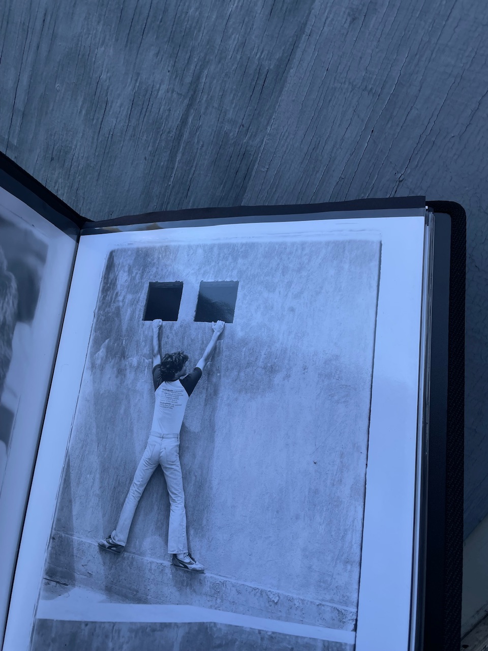

A few hours ago I started a thread about toning, and in the discussion I discovered that I'm not doing a great job at storing my prints: I've been storing them in an album with adhesive plastic sheets that cover the print. I've been advised that ideally you don't want anything pressing against the print, and to the extent that anything touches the print, it should be acid free if at all possible.
I like albums. I think I found a way to make an album that meets the above guidelines:
(1) Grab a scrapbook that is just plain acid-free paper (example), and
(2a) Either use acid-free tape intended for artwork (example) to stick them directly on the paper,
(2b) Or use acid-free archival photo-corners (example), so the print is not actually directly glued or taped to the paper.
That should be fine. Right?
I understand that the optimal way to store prints is in an acid-free archival box, and I will probably do some of that too. But my feeling is that the purpose of making prints is to look at them. So I'm reluctant to hide them too much.

Have you considered the relevance of your prints surviving for decades on end?
I am only interested in them lasting in good condition within my own lifetime.
Nowhere in my post, as far as I can tell, did I suggest that I wanted the prints to outlast me. Looking at actuarial tables for my age, gender, and country of residence, it looks like I have about 30 years left in this world. Let's use that as our point of reference.
If the album I've been using so far (link), with a sticky plastic sheet holding the print against the page, is sufficient to protect the print for my target period, then I'll just keep using that. My understanding from the previous thread is that anything pressing against the print is bad for it.
This is one of those times where I get conflicting information from this forum. In my other thread,
1) my first question was whether archival is important.
2) I said I keep my prints in an album and asked how long they'd last.
3) I gave the example of just wanting to record my progress as a beginner.
The answer that I got was that as long as I fix and wash properly they'll last plenty long, but that something pressing on the print is "terrible" for it.
Hopefully this context will help calibrate the responses that I get now.

Toning for its protective properties can only ameliorate to a limited extent #3. So if your concern is in the 'pressing' problem (no pun intended, but hey, if I get one for free...), then toning really isn't the solution to look for to begin with. It's the storage conditions and materials.
That... is why I started a new thread. 🙂
Notice that in this thread I did not mention toning. I asked about storage.
In this thread I suggested I could get a new album with acid-free paper and no plastic sheet covering the film. My goal was reduce the amount of contact on the prints, and to the extent that the prints touch something, that it'd at least be acid-free paper.
From a practical viewpoint, anecdotal evidence suggests that stacks of prints and prints in decent-quality albums tend to survive just fine for decades as long as humidity isn't too high. The tropics are disastrous for prints, in general. Temperate climates usually constitute no problem if you take reasonable precautions - cellars, sheds and other spaces of high humidity are not the best places to keep your photographic memorabilia. A plastic box with a lid will preserve a stack of decently processed prints for a long time without any problems.
Thanks.
Do you think I need to worry about the sticky side of the sticky album plastic sheet permanently gluing itself to the print or degrading the print?

I'm not sure if any of us can comment on your prints in an album question unless we happened to have prints processed the same way and stored in the same album. Like most paper-based stuff, UV and humidity are the killers. I too think the albums with the sticky plastic are not a great idea. Maybe the adhesive is on the page and not the plastic, but same opinion from me either way.
I like your non-plastic album and photo corner idea. I've been noticing a bunch of "family album" albums with black paper and variously decorated covers showing up at antique stores and junk shops lately and have been thinking about compiling some of my work into them.
Thanks!
Yeah. The more I think about it the more I feel the sticky plastic could glue itself permanently to the print.

Those are the worst. The glue yellows and hardens.
You could get those presentation binders at an art store with the black construction paper in sleeves that can hold two prints back to back (or a few, like if you make three prints if a particular negative you could stack them). A few of those to hold a couple dozen of the favorite prints for flipping through.
Best would be an archival acid free box with tissues, and only handle with cotton gloves.
My “default” is just keeping prints in the boxes the paper came in. They are affected by handling, dinged corners, fingerprints. I don’t like it.
