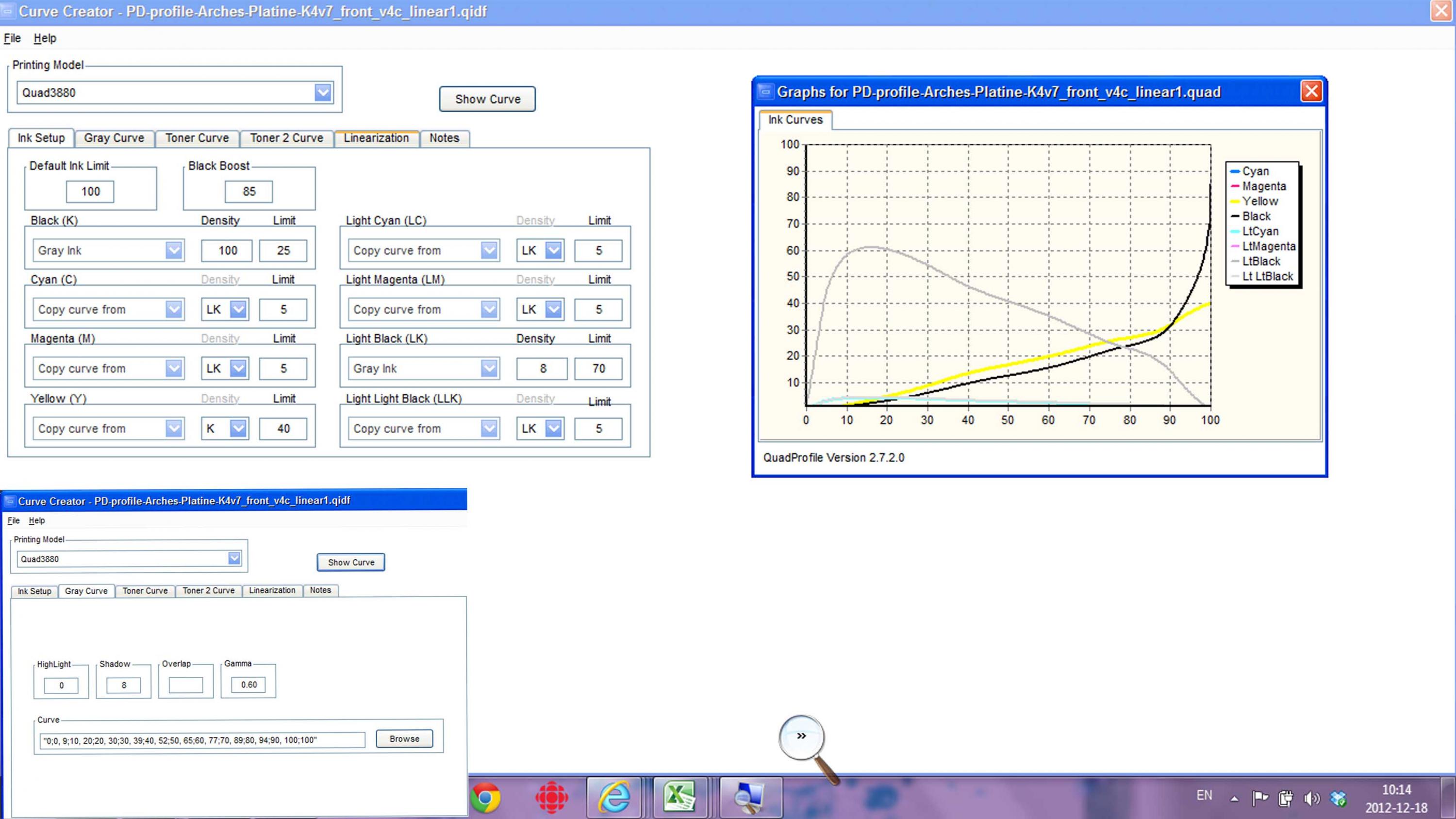

I am getting the mottled look and especially where there is little tonal variation in a part of the image. It most often expresses in the upper-mid tones towards white (Zone VII +). I was suspicious that it may have to do with the negative, (which looks "grainy" in the same part of the tonal range.) I am using MK to get enough blocking to reach dMax in the negative on an Epson R3880 printer. I have been contemplating changing to the Jon Cone inkset to see if that addresses the problem.

Using MK ink tends to make negatives that print grainy in pt/pd. Not recommended for digital negs, IMO. I use a 3880 now and a 3800 before that. You can get the density you need without MK ink. PK is the way.

I was unable to get Dmax (pure white on print) using PK, which was why I jumped to MK. (I am using Lithium Chloropalladite, Ferric Oxalate, and NA2 - 2.5% at a ratio of 20:20:1, and Potassium Oxalate developer (2 min), Water bath with citric acid, EDTA and Sodium Sulfite baths (1 & 2), followed by rinse.)
I have been contemplating jumping to the Jon Cone inkset for digital negatives -- see Digital Negative Update | PiezoPress It is a pricey initial expense, and if it solves my problem and yields low-grain smooth tonal transitions I will be a very happy camper.

I also find MK to yield grainier negatives than PK, so I don't use it for carbon transfers. PK is a poor UV blocker on the 38xx, but I can get extremely smooth tones in palladium using MK and colorized negatives; the prints are visually identical to prints made from negatives printed with Piezography ink on an Epson 1400. If you are using colorized negatives you may need to find a different color as this can affect graininess. If you are using a QTR profile you may have to do considerable tweaking.

Hi Philip. I went down the MK road with QTR during the summer, and it was intensely frustrating. MK seemed to answer the problem ... except for that damned mottling.
So now I just want a good solution, and Jon Cone provides a set of correction curves for different density ranges that looks pretty promising. The distribution of inks looks well balanced in the curve set that he provides. If anyone here has experience using the inks and correction curves he has provided, please chime in.

Right. That's why I said "If you are using a QTR profile you may have to do considerable tweaking." :smile: Colorized negatives on the 38xx using MK are quick and easy and provide very smooth tones using inks you already have. The mottling you saw might be caused by a QTR QTR profile that is laying down too much ink and the negatives are drying unevenly. This would be my guess since you reported the mottling in the upper midtones and highlights. If this is the problem it is easily remedied.

Thanks for the idea Arton, I will see about sourcing another paper for purposes of testing. I do note that I can see "graininess" in the negative, and especially where Y and MK are laid down heavily. (Y and MK track closely in my correction curve until the last 10% of the curve when the MK curve starts bending to a steep slope.) The graininess starts manifesting around zone VII (70%) on uniform background such as sky.
I have included the curve for reference as an attachment.
My sense is that the graininess is related to MK and the curve becoming predominantly Y & MK alone from 80% on. My hope is that the Jon Cone inks and curves will put this to bed once and for all. (As Philip alludes, it is a bit of a leap of faith to change up the inkset, and an expensive one at that.)

If you really want to change inks, go for it, but your QTR profile is the most likely source of your problems. Most are probably using native Ultrachrome in the 38xx and achieving good results with QTR or colorized negatives, so my suggestion would be to run a few more tests before switching. QTR is a tweakers delight, so I would take that out of the equation for now and try colorized negatives. You have everything you need so the cost is only a couple of hours of your time. PDN works well, but you can use RNP arrays to determine an appropriate color: Dead Link Removed.
If you still see mottling, then time to reexamine the platinum printing workflow.
