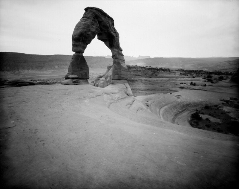

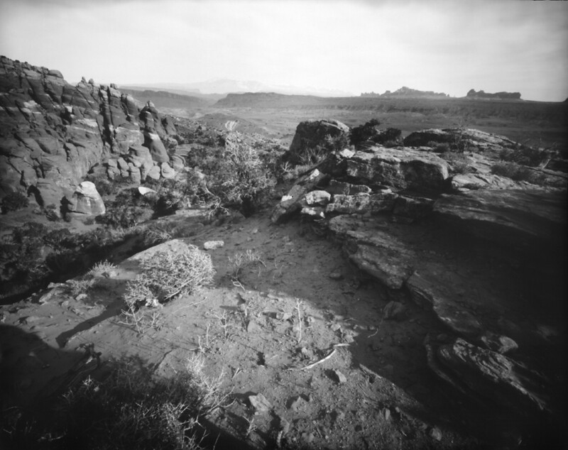

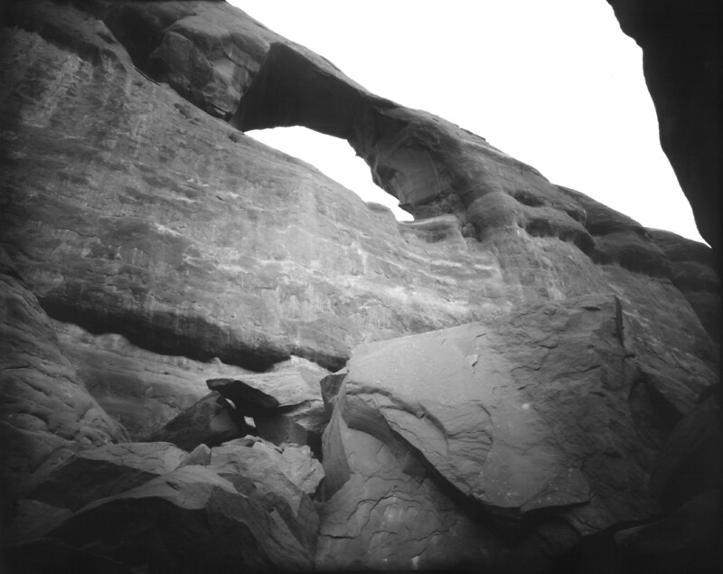

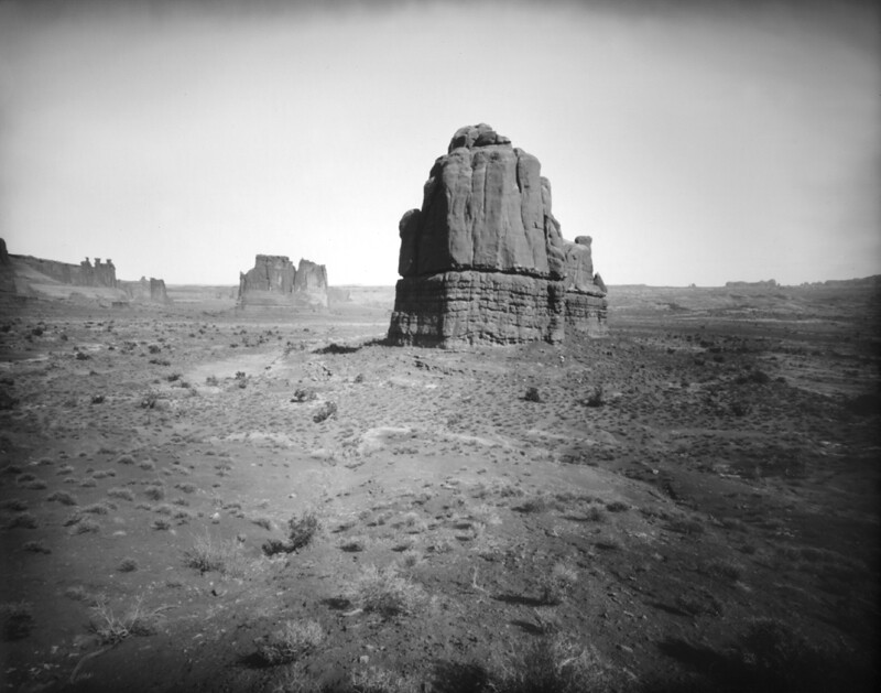

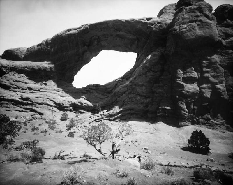

Shot some paper negatives in my 8x10 box camera last week at Arches National Park, near Moab, Utah. All images using Freestyle's Arista-brand grade 2 RC paper, post-flashed prior to development, developed by inspection in Ilford Universal paper developer mixed 1+15 at 68f. The paper I rate at an Exposure Index of 12. Exposure times varied from around 30 seconds to several minutes, depending on the light.
~Joe
Delicate Arch:
Skyline Arch:
Fiery Furnace Overlook:
Turret Arch:
Courthouse Rock:
