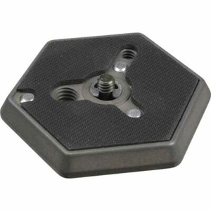

I'm just curious, I was looking through a long list of arca swiss type mounting plates both on B&H and on eBay, and I don't think I saw a single one that had set screws to hold the camera in place and keep it from twisting. All my Manfrotto hex plates have that which is very useful when mounting an 8x10 camera with 60cm of leverage.
Am I looking in the wrong place or do they just not make them? I did find a bunch with the raised edge which will probably for with the camera I need a solution for at the moment, but what about cameras with a circular base? How to you hold them in place? Or should I stick with Manfrotto hex plates for those cameras?

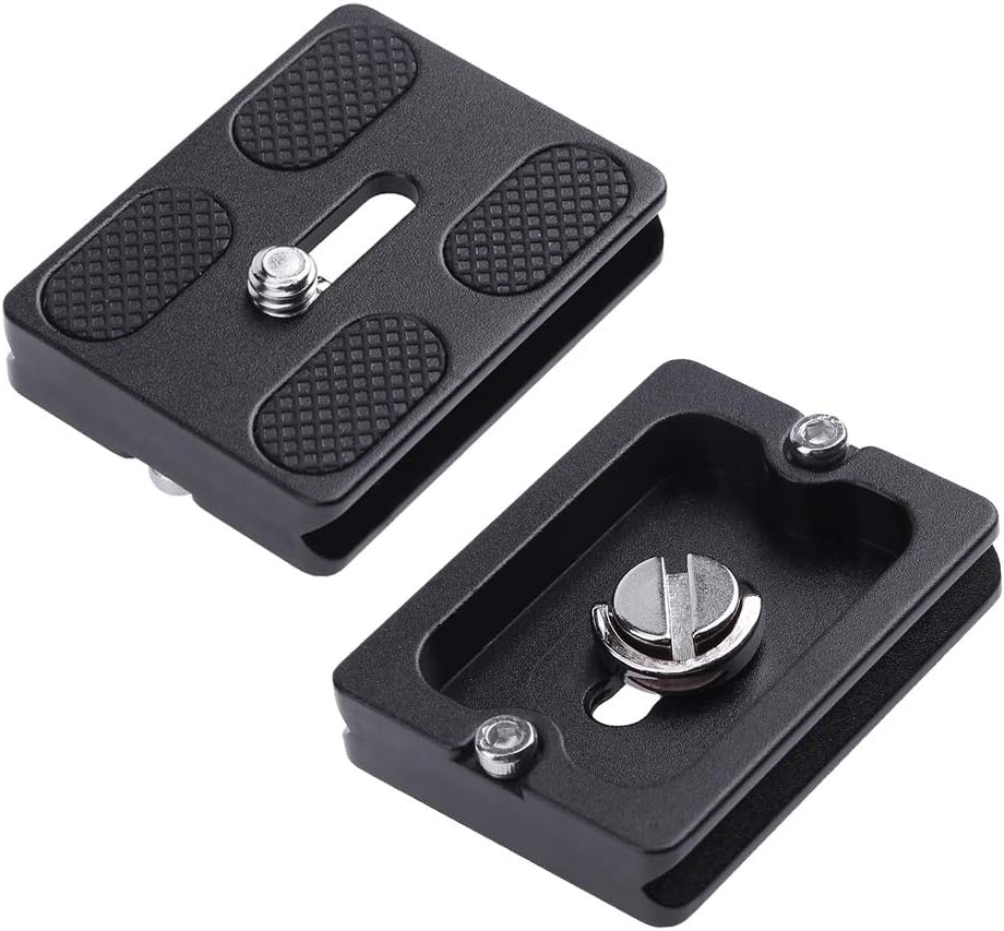

My 8x10 Nagaoka has two mounting holes so I purchased a 100mm plate that has twin mounting bolts that span them and locks down without any twisting.
https://www.amazon.com/dp/B091DLW21H/ref=cm_sw_em_r_mt_dp_WNJD150PGXHXS0E3X2E2?_encoding=UTF8&psc=1
Just a quick search on Amazon.
You can find older RRS plates on eBay that can have set screws on the side of plates.
I use an older RRS 3/8 plate with a ridge on one side for my partial circular tripod mount on my Cambo Wide 650 that I found on eBay.
Good Luck!
Those don't look like set screws to me--they don't pass through to the underside of the camera, so they're not going to help fight twisting. I saw lots of plates like that, but I don't know what those screws are for.
EDIT: you can see the three set screws on Manfrotto hex plates here:

All those set screws do is keep the mounting plate from sliding out of the pan or ball head once you've clipped it in.

Manfrotto have/had a couple of "architectural" versions of their plates, that added a sliding plate designed to be in contact with the front edge of the base of a camera and thus prevent the camera from twisting.
I'm not sure how that might be implemented with a view camera.

Generally I've used long plates and multiple screws if the camera has multiple mount sockets to prevent rotation on large cameras. I think some people are averse to the set screw method as opposed to the lip as the set screws can mar the bottom of the camera. That being said, there are a number of Arca compatible plates that have holes tapped all the way through for numerous 1/4 and 3/8 holes, like this Kessler crane plate; you could get one of those and pick up some flat headed set screws to use the same method that the Manfrotto plates use.
