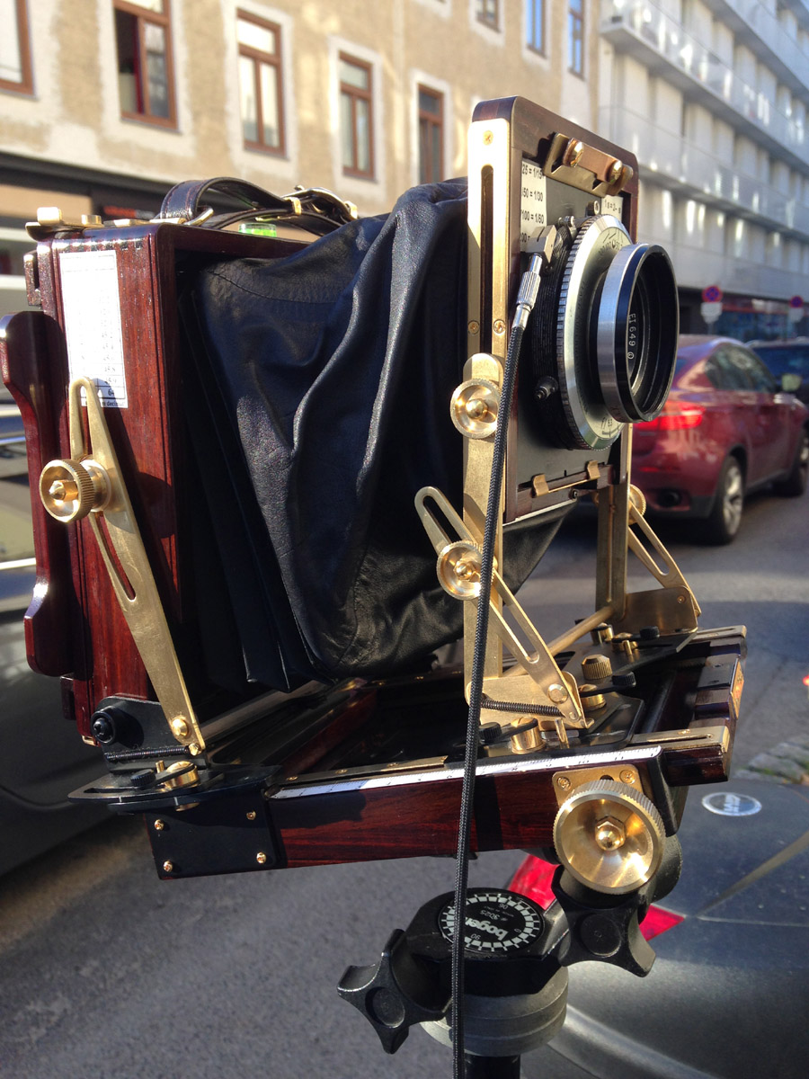

Here's a photo of my Wista SW, with the wide-angle bellows and a Wide Field Ektar 135mm lens with a 229mm image circle. I've used both front standard rise plus pointing the camera up and tilting the standards back parallel to get more effective front rise than I could get with the rise movement alone. I've also tilted the front standard a bit forward to position the plane of sharp focus where I wanted and I've used rear shift and swings on both standards to frame the image since the ideal camera position was not available. I used just about all of the coverage this great little lens has to offer. FWIW, the shot was a close-quarters outdoor architectural shot.
Hope this helps,
