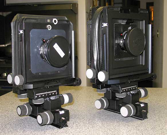

At this point, abiut $2200.00. I am a huge advocate of the optical bench as opposed to the folding rail. The camera can be stored more compactly, assembled quicker and is more rigid than the folder. I didn't think any camera could be better than my 171 Fmetric until I saw the new 141 at the View Camera conference. The 141 full Fmetric w orbix is the most complete setup possible, you may use all the AS front accessories ( like the Technika adapter) but you can't on the field. I can draw from 58mm to 720 tele with the new bellows and an additional small rail I carry. I am attaching a photo of the two cameras side by side...EC
