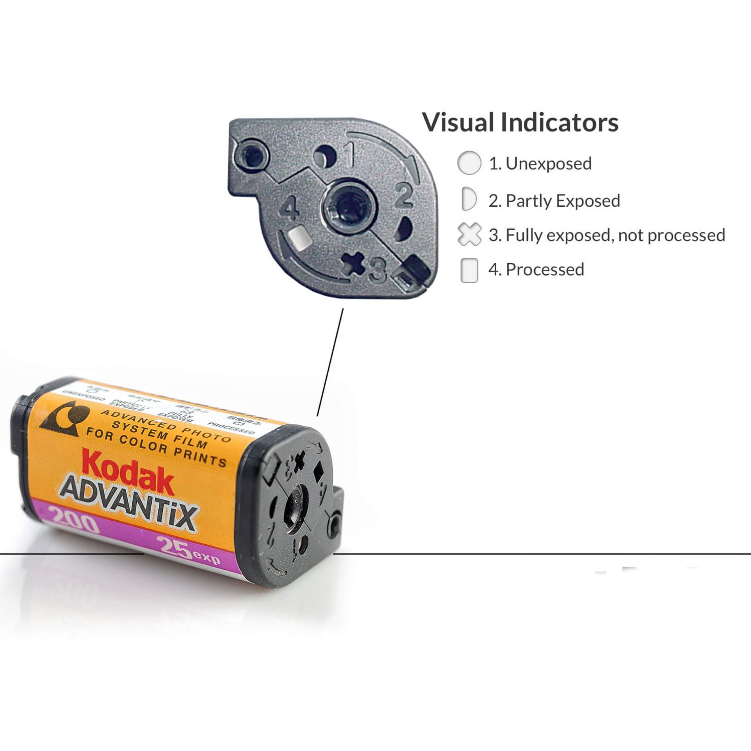

If you gently insert the tip of a scissors into the center spindle of the cassette, you should be able to turn (clockwise) and change the indicator. It should make a click sound at each number.
You could try this with a processed cassette (4) and change it to (1), load the camera and see what happens.

I see what you mean, the contacts of the opposite side of the cartridge like in this picture on Etsy
https://i.etsystatic.com/9129297/r/il/f62c1e/2006979672/il_fullxfull.2006979672_2g3c.jpg
I'm not at home at the moment, but I could take photos of a new and of a devlopped cartridge next week. If someone has them at hand please help...

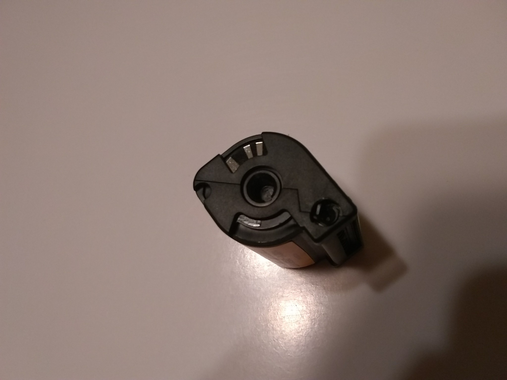

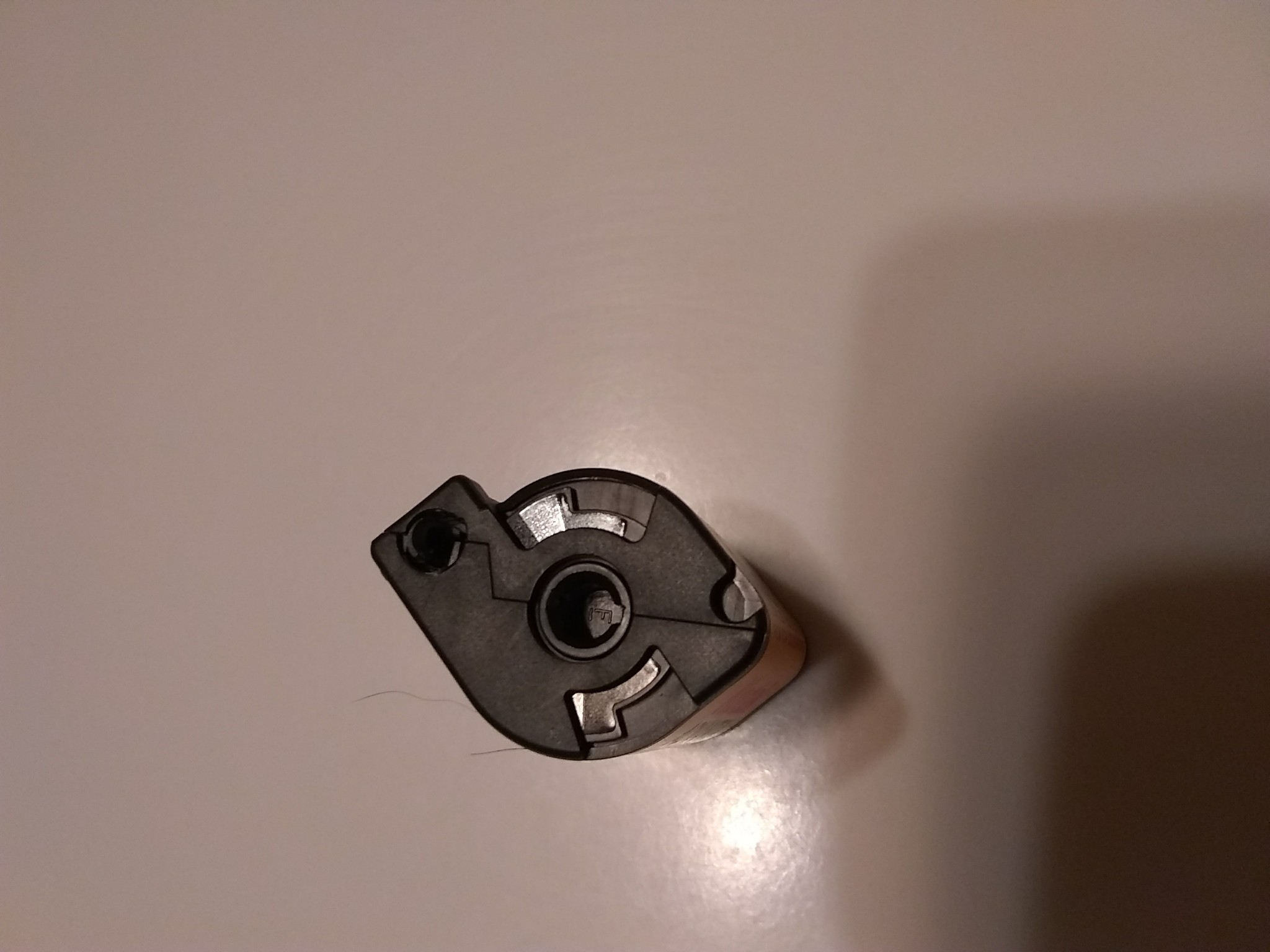

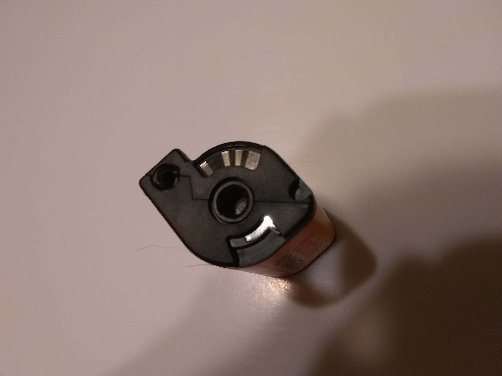

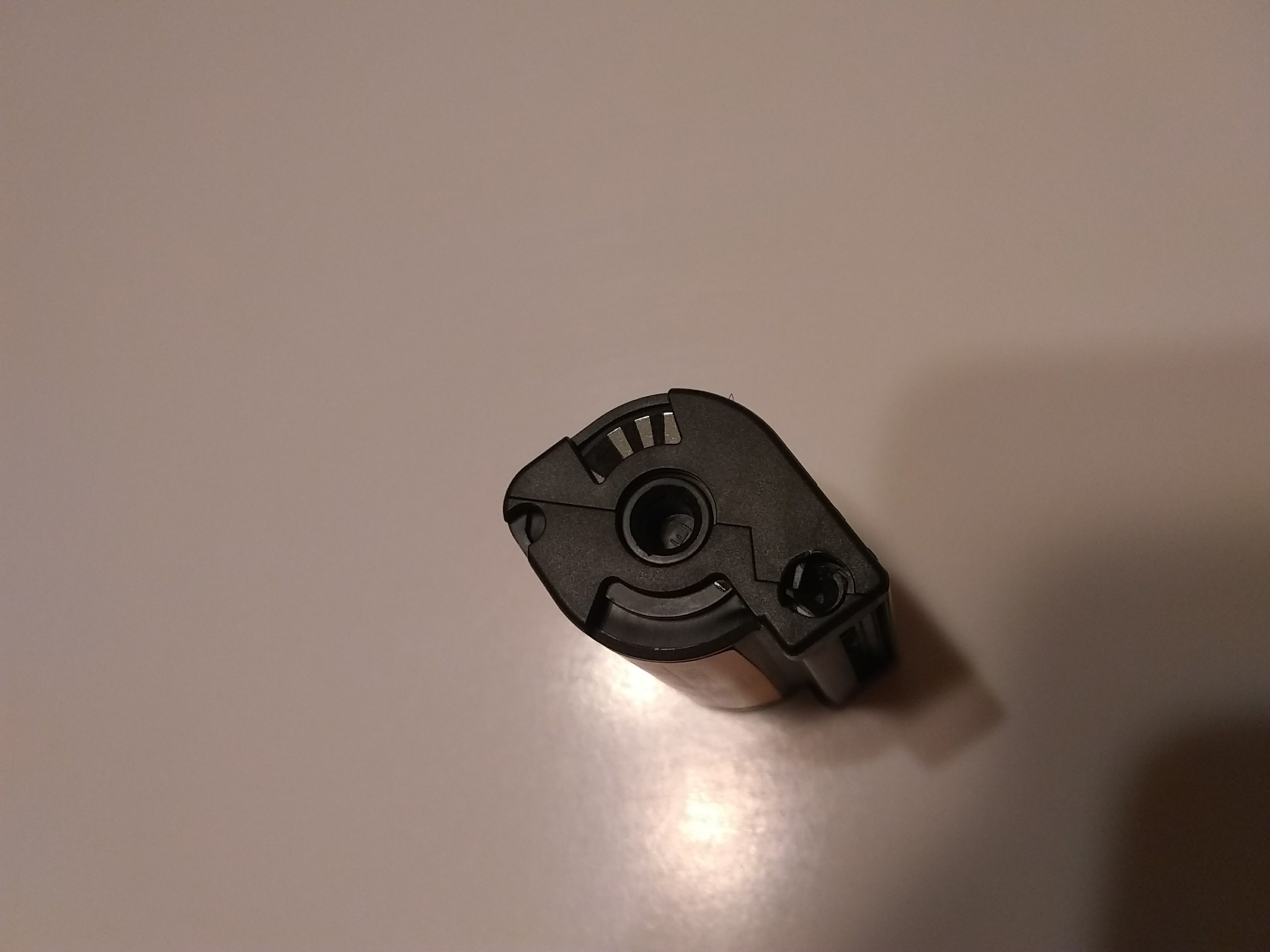

Here is your APS in picture order.
First is new film.
Second is film partially used.
Third is film exposed.
Fourth is film developed.
Eric
