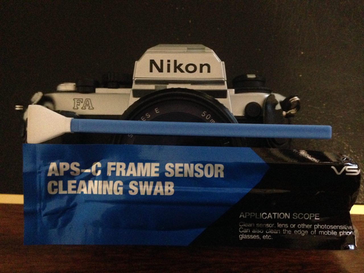

I have tried a few different ways to clean the mirror, viewfinder and prism mirrors on my old cameras with varying results. Purchased a pack of these APS-C sensor swabs for the digital back on my Nikon FE as the sensor gets a lot of dust on it so close to the shutter of the FE. So test tried a new swab on an old dusty Minolta MG1. It cleaned the mirror to perfection, removes all the dust spots on both sides of the viewfinder and cleaned up the prism mirrors with no damage at all. Have since used it on my other better quality SLR cameras and found it works a treat. Once finished with the internals, the swab is excellent for cleaning the external as it removes grime from those hard to get to crevices & between dials.
What other methods do you find useful for cleaning the mirror & viewfinder & prism internals?
I use wet patches cut from a folded soft paper tissue.
