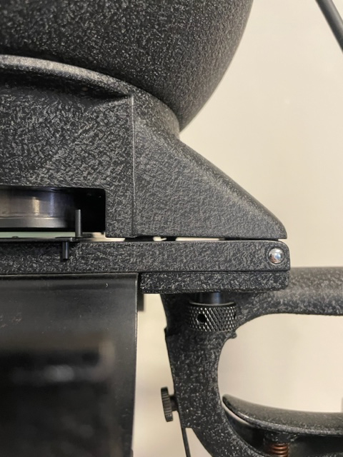

I bought an Apo Rodagon, but I couldn't see any improvement over my El-Nikkor. The Apo is back in it's box and in a storage cupboard - can't really say where. I was thinking of putting it in an Leitz Valoy, which has a 1/2 glass carrier and holds aligment really well (certainly when compared to my Beseler MX-something-or-other).
Nicholas, I assume with this 1/2 glass carrier you mean the 3x4 or the 4x4 carrier? These being 35mm negative carriers from Leitz.
Actually, these should only be used with the Focomat Ic. Because of the added 2mm thickness of the glass, the head of the Valoy II gets pushed upwards by 2mm on the front side only. You can clearly see this from the side. It causes misalignment. See picture.
Contrary to the Valoy II, the Focomat Ic has a condenser that's held down with a spring and simply moves upwards 2mm when this 3x4 or 4x4 negative carrier is used.
