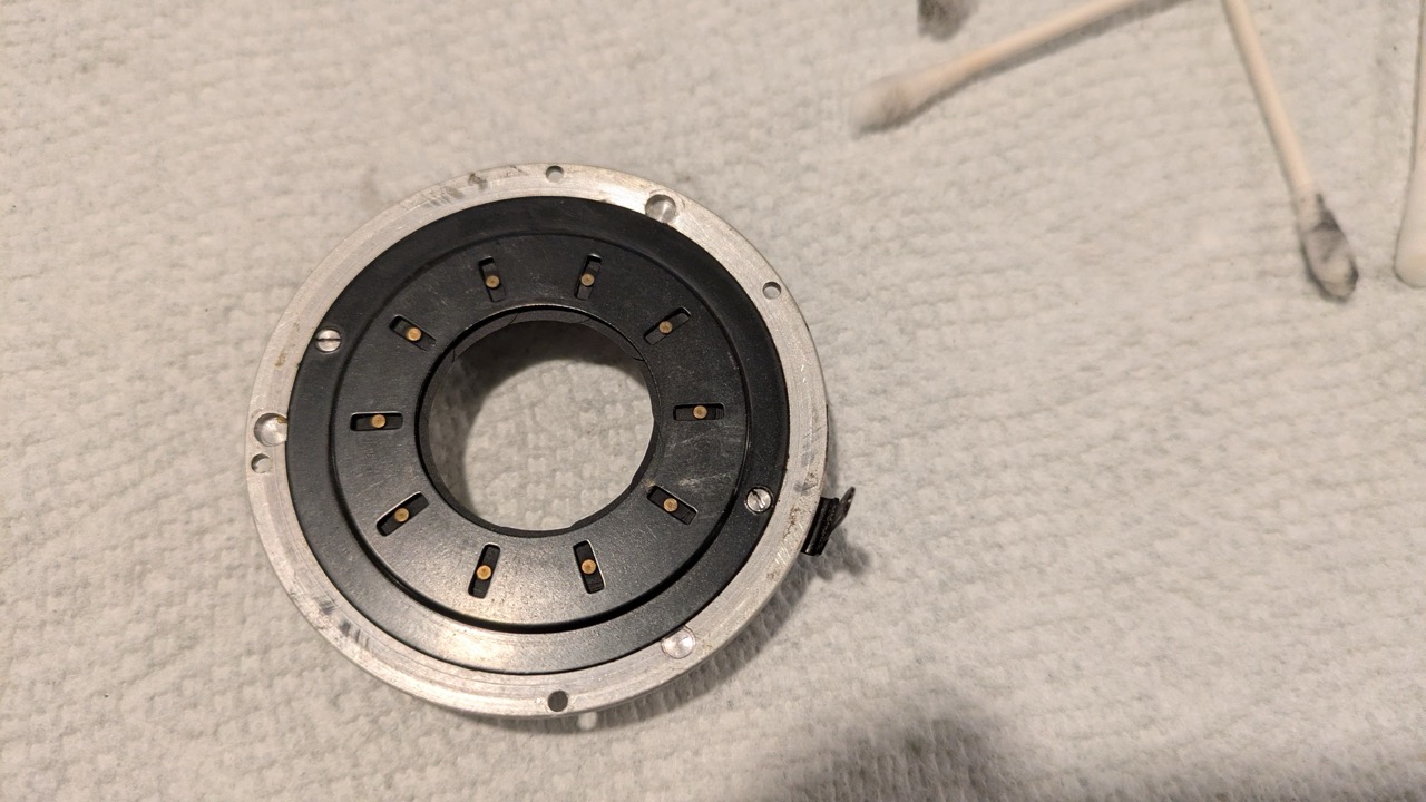

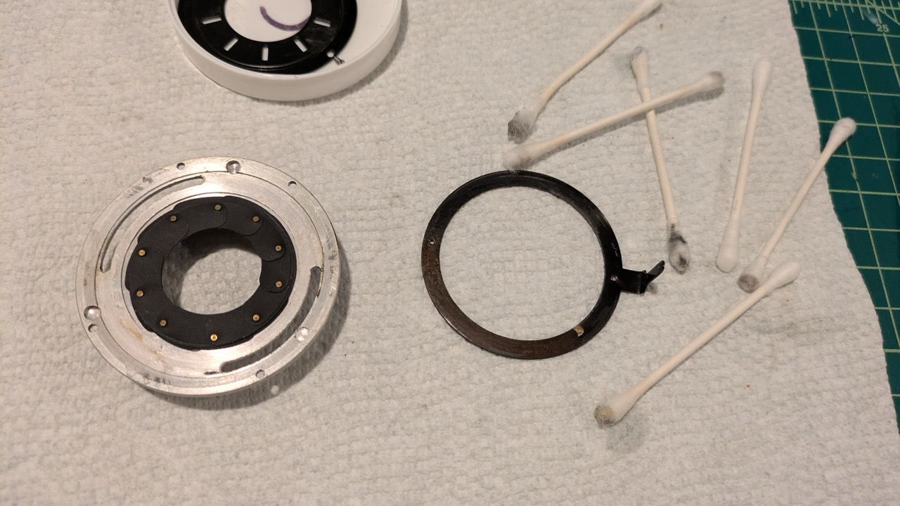

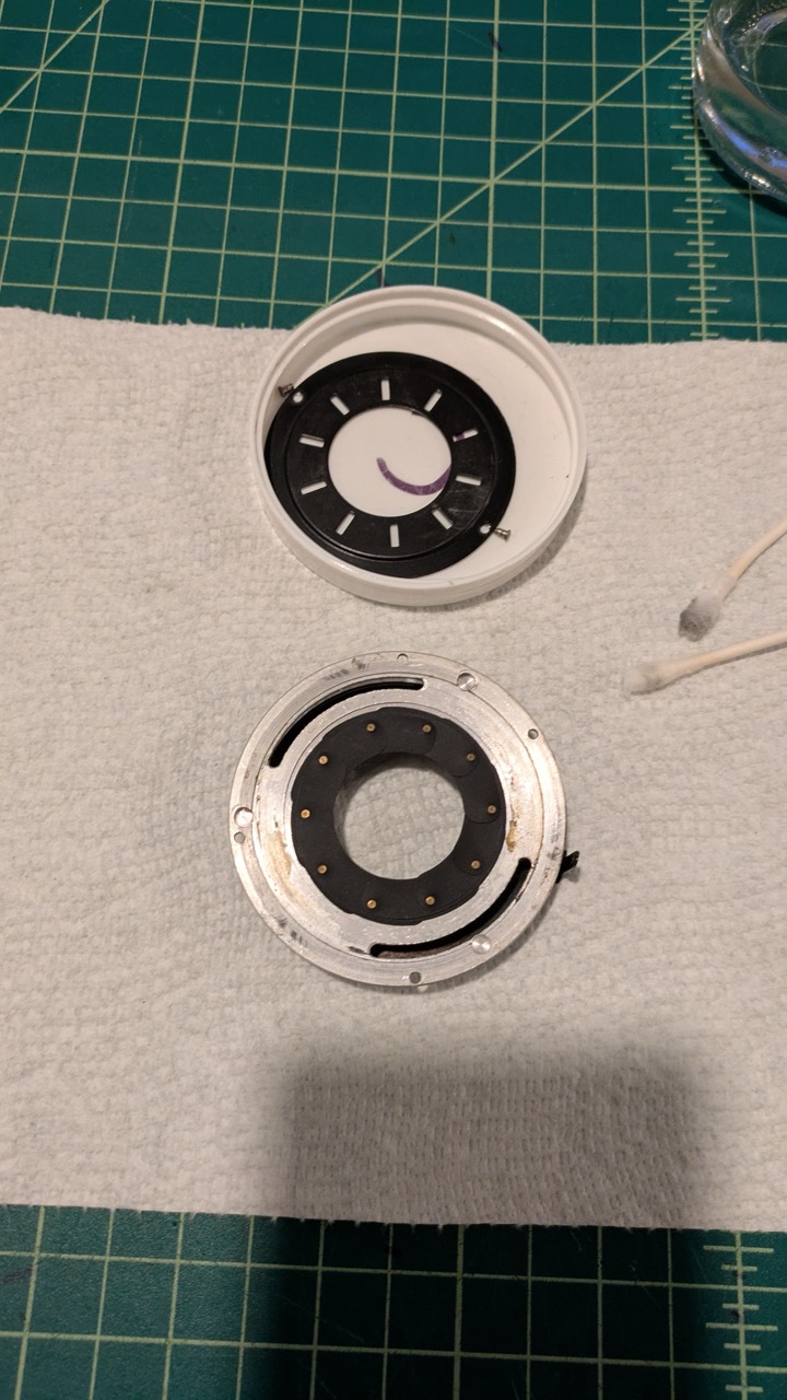

Hi,
I try to perform CLA on this Ibsor shutter, from a Voigtlander Avus camera with Anastigmat Skopar lens. The shutter itself is all done and all speed are good now, but the aperture is a bit strange.
It is clean and dry, without any trace of oil or grease. But it is very difficult to turn from f/5.6 and beyond. If I use some force, it can indeed change the aperture to smaller, but soon some pins might pop out of the groove, and difficult to get back into the groove. I open the entire thing very carefully, and I don't see anything wrong with the assembly. Do you happen to have any experience with this? thanks! I attach three photos of the aperture assembly. The oily cotton swabs are not from the aperture.

I have no experience with this shutter. Just a few suggestions from a bystander.
  • Wear/corrosion/abrasion in the grooves where the pins slide; perform a visual inspection with a strong magnifier and oblique angle of view, and visual inspection of the sliding pins...
  • Residual dirt; no offense meant, see 2nd picture, but maybe it's purely visual...
  • Try some dry PTFE lubricant

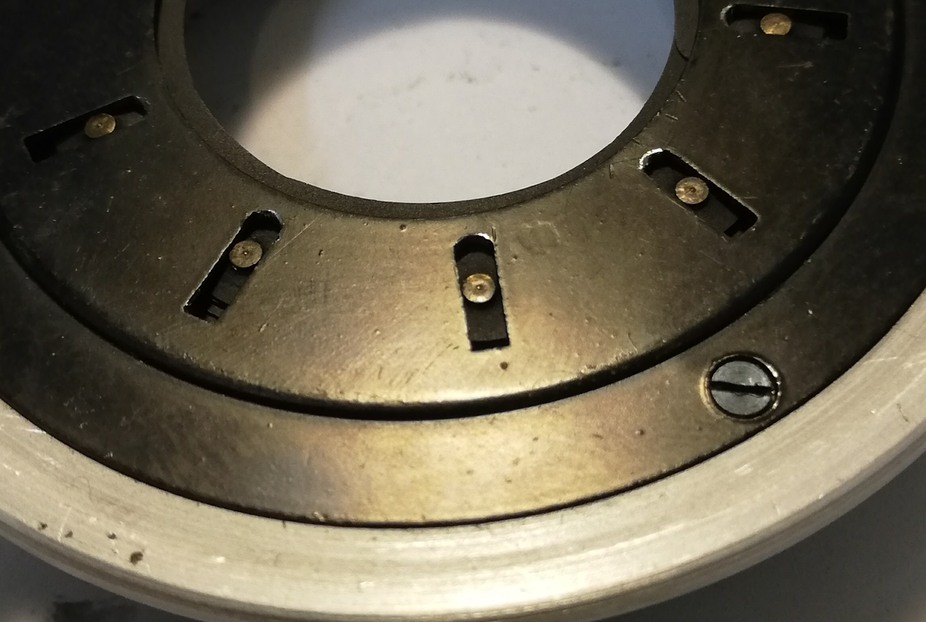

I did one of these a few months ago and had a similar problem.
One of the pins had come out of a leaf and the whole thing was jammed up.
I made another pin and riveted back onto the leaf. On assembly it was - as you say not right going to smaller apertures. I assumed it was a previous repairer had used the wrong leaves and that had lead to the damage and improper operation. I modified the slots in the plate with a small round Swiss file (see picture), checked the apertures (all seemed close enough) and left at that.
Definitely no lubricant.
I assume leaves are the correct way round (Can't remember if it is even possible to do them wrong :smile:).
I'm not sure but I seem to recall the leaves on this are some sort of plastic!, could have been another iris I was doing at the time but be careful with cleaners, acetone can melt those ones!

@blee1996 have a look at the pins as the blades move if they touch the ends of the slots like mine did this may well be the problem (poor original design?) I thought mine had maybe been replaced but yours look identical.
Steve.
@Steve906 I fully agree with you that the original design was poor. There was no oil or grease in any of the aperture blades or mechanism. In the end, I enlarged the slot a bit like what you did in the previous post, and now it is much easier to adjust aperture down to f/16. Very seldomly one pin will still pop out temporarily, but it will go back when the aperture is opened. So I will leave it at that.
