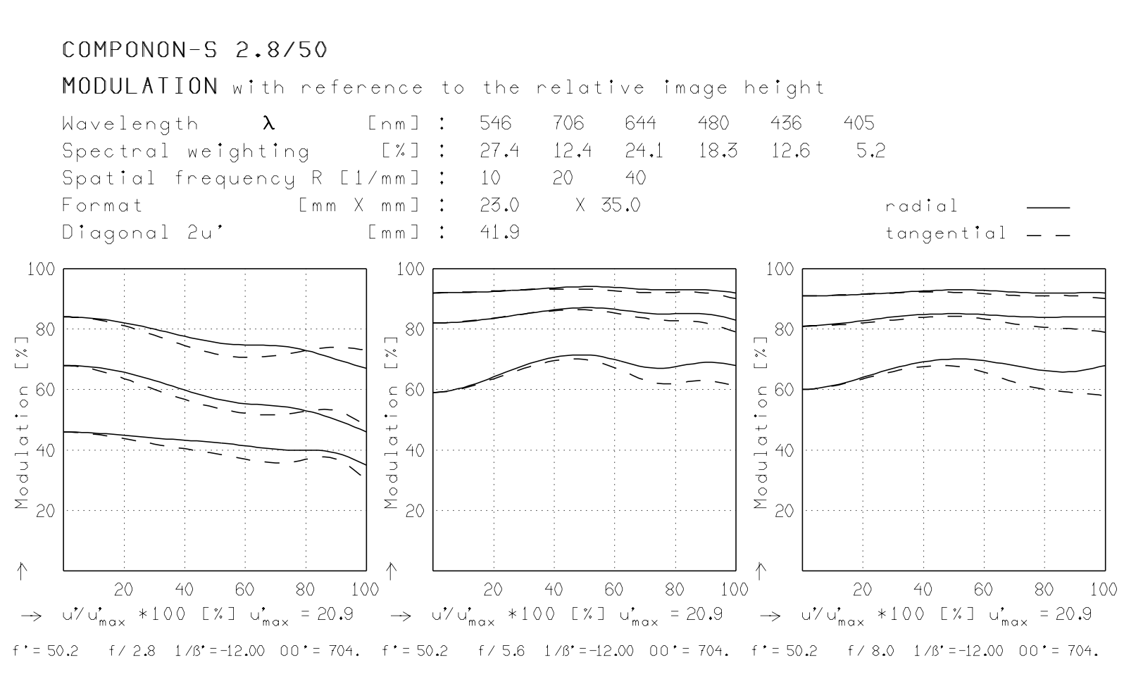

Here are the MTF curves for 2.8 (wide open, smooth circle), 5.6 and 8. As you can see there is a dramatic improvement at f8 over f2.8, in spite of your worries. BTW where did you read that about he number of blades, I never heard of that in all the Schneider or Zeiss literature on pictorial lenses. In fact one of my favorite Zeiss lenses has only three blades and my coveted EE Switar which has only two!
