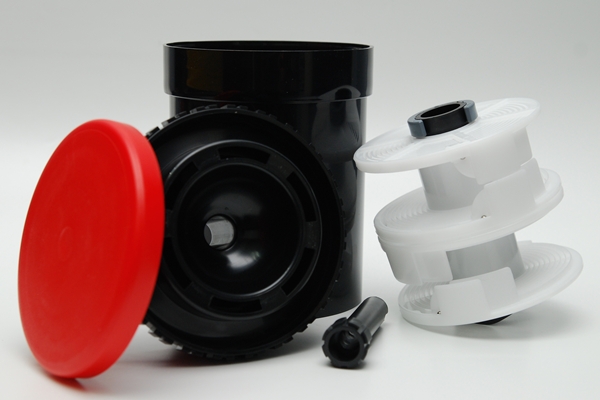

Hi, I suppose the tank you have is the one in this picture, or something similar:
If so, then you can see that the reel is attached to the central tube, through which the solutions will be poured. This also ensures that the tank is light tight . The other tube you see in the photo is used for rotation agitation. You don't need to use it, you can agitate by inverting the tank, which IMHO is a better method. I've had streaking happening the only time I did use this thing and it seems that I'm not the only one...
MattKing
Apr 24, 2005
51,974
Delta, BC Canada
Those AP tanks and reels have a couple of advantages over the equivalent Paterson tanks and reels.
The tanks are shaped so as to permit rotary agitation by rolling on a flat surface - they sit flat on a horizontal surface.
And the reels (which are interchangeable with Paterson reels in both types of tanks), are much easier to load with 120 film, due to the wider flanges.
