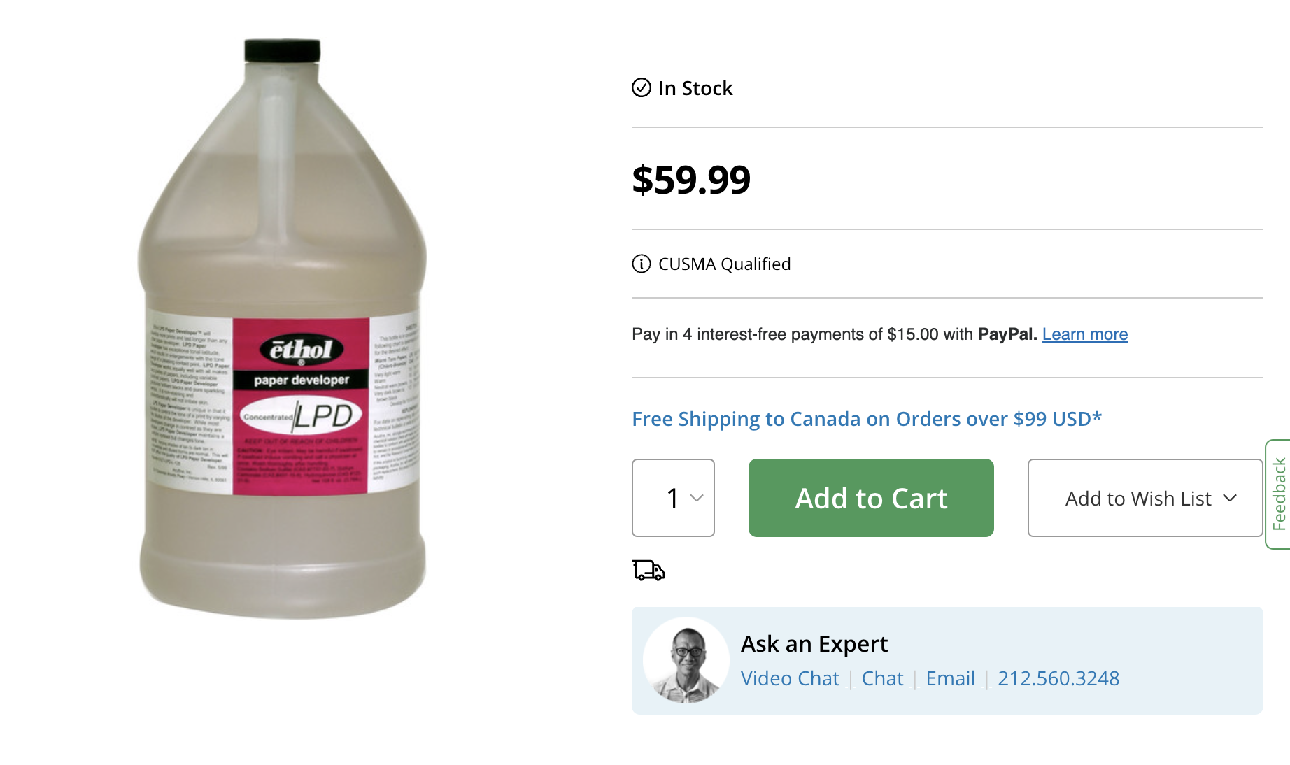

B&H has gallon jugs of LPD @ $59. .....while its $82 at Freestyle.
It's one of my favourite developers and lasts well.
Ilford Multigrade is $78.50 / 5 liter jug.

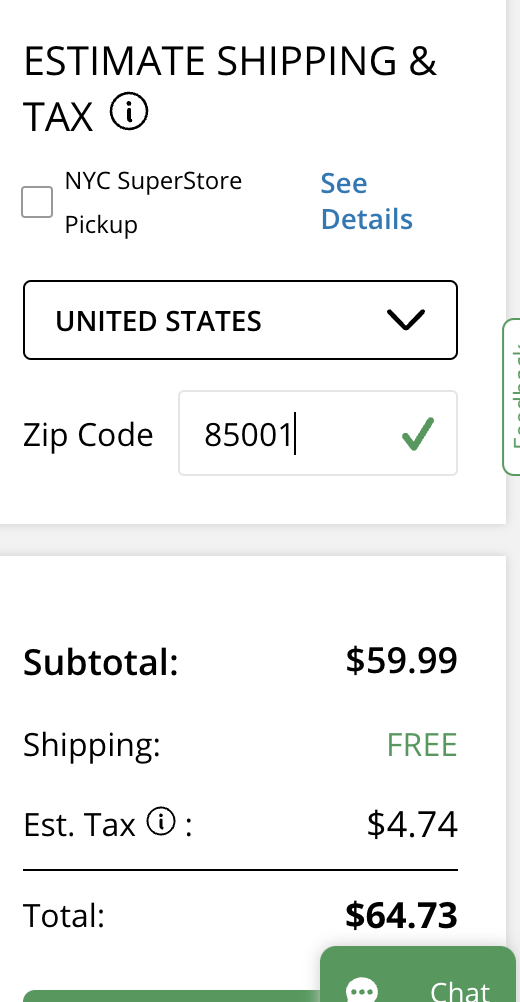

Since we were talking about liquid Ethol LPD to begin with... it can be shipped in the USA.
GregY
Apr 12, 2005
3,982
Alberta

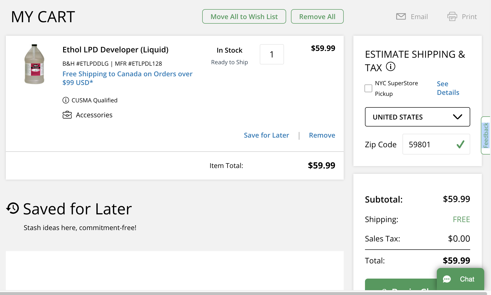

& for Paul's benefit B&H will ship to Arizona....
Does anyone have an actual example of a product they will ship to Canada but not the USA ?
Paul Howell
Dec 23, 2004
10,085
Scottsdale Az
For some items I am assuming that B&H will ship but I cannot order online only by telephone. I had thought about the free shipping, it seems the heavier items are restricted from online orders. Now that Photo Wearhouse (Ultrfine) has relocated to New York I will likely buy more from B&H.
