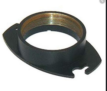

You could have one of these made too.

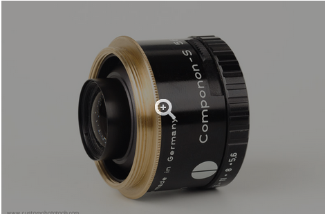

Or maybe the 50mm screw adapter for Omega (that fits on a flat plate) could be fitted to a flat Beseler plate?

I'm not sure the ring in the first photo would do the job. The Omega adapter would be easy enough to use, assuming I can find one, but I don't know how much extension it offers. I'm aiming for 1-1/8", which is an available thickness for 6" x 6" aluminum plate from McMaster-Carr.

I use that Omega adapter for my 150mm Componon-S. The adapter provides clearance of the rear elements on the 3-way turret so it can spin without decapitating the rear lens elements.
