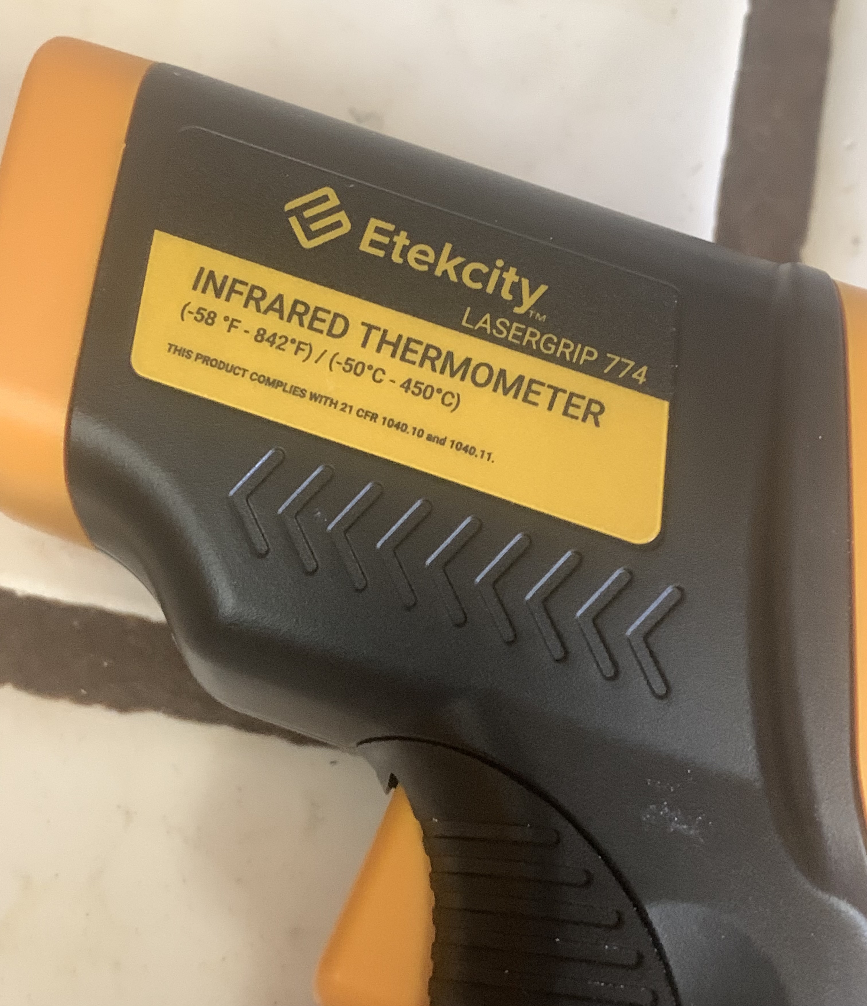

Mine's black and orange and called Kizen. They're probably all made by the same folks.

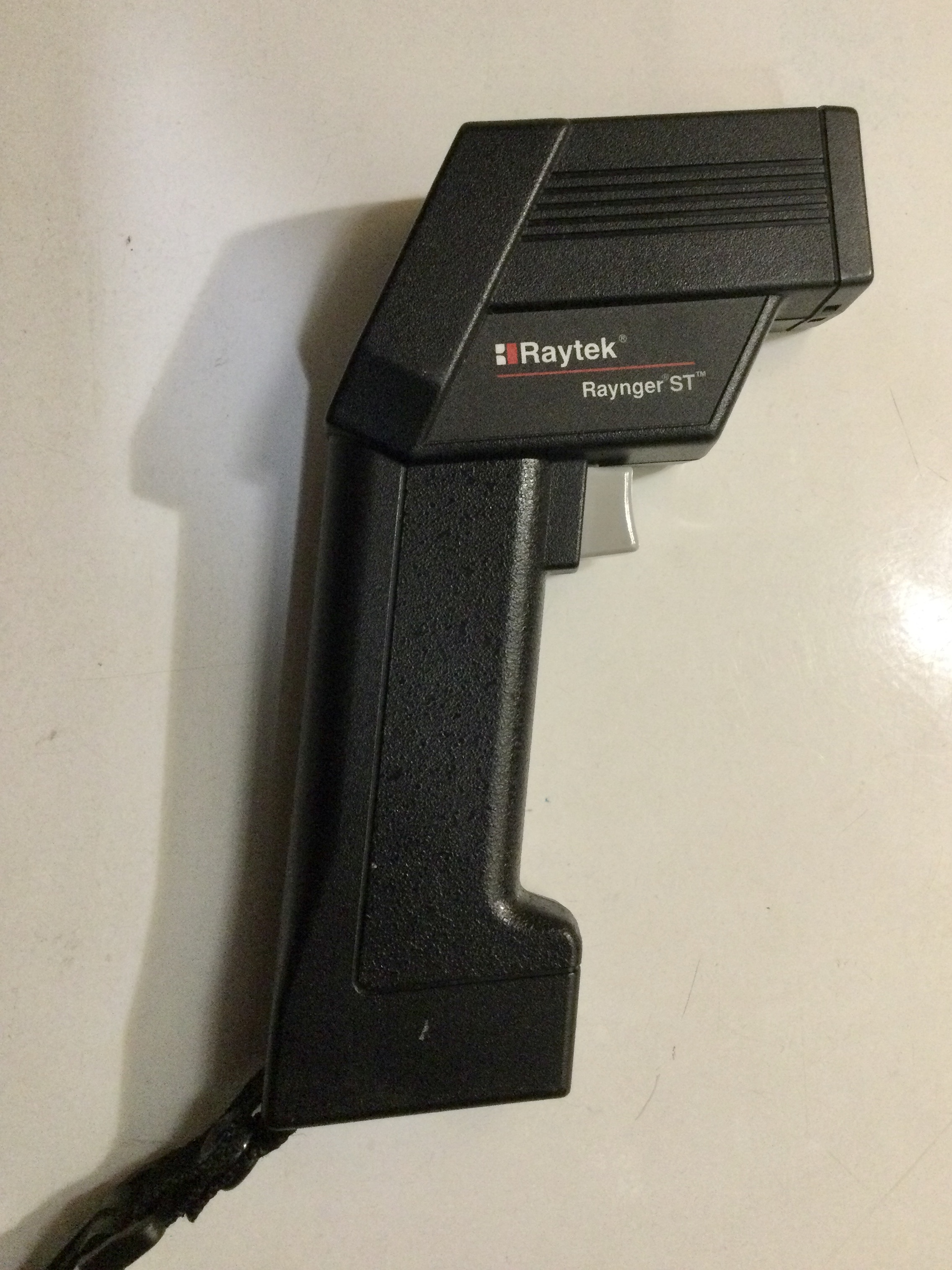

This is the one I use, it’s actually made in the U.S.A. It’s an older one that I used for work years ago.
