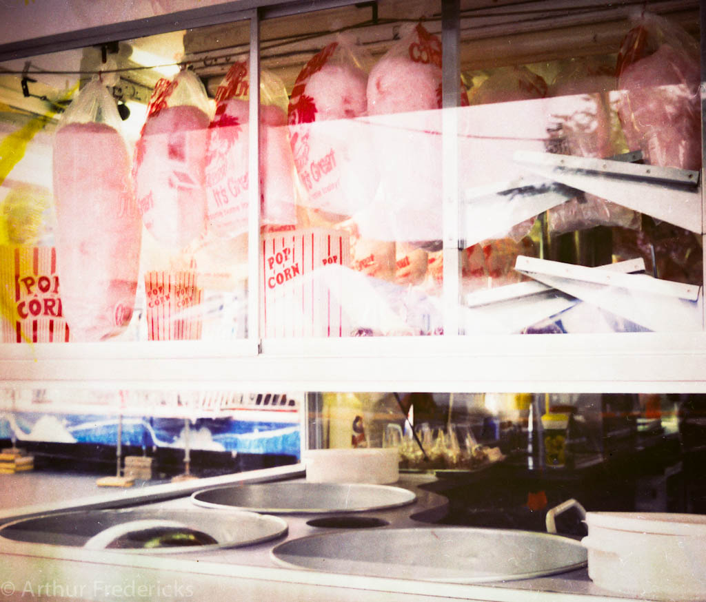

Yes Clorox laundry bleach is what I use.
Here is example of what I was able to get with old polaroid camera and Fuji instant film
